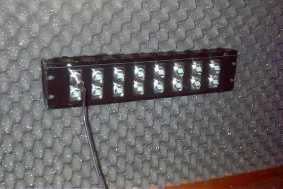

I fabricated this out of a blank two space rack spacer and Switchcraft panal mount XLRs. I used a hole saw to drill the holes in the spacer and soldered it up to some Beldon cable. It is in the wall between the controll room and the live room.

very nice, how much did that cost you and where can i get those parts at. thanks for the picture
