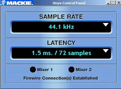

if you actually open the mackie onyx control panel (through control panels, or start-programs-mackie onyx), you can see what your latency setting should be, based on your buffer size (it tells you, haha.)
well...no it doesn't...it gives you options for each of the 4 sampling settings....
how do you know to choose the correct option?
Below is the window I see.
under Latency, that is the buffer settings.
Mackie has been nice enough to tell us the default latency times that the onyx has based on the different buffer settings...so whatever it's set to, that's what you set your program's latency settings too, so it will correct for this automatically from there on out.... If stuff is really delayed, probably have buffer settings too high. If stuff is poppy and clicky, then youyr settings are too low. somewhere in the 256-1000 range is probably fine.

yes...but you can change the latency settings for each sampling rate...
How do you know which is right?
Is a higher sampling rate with a longer latency better or worse for quality?
Or does it have anything to do with using effects?
We like to use a lot of real time digital effects....
And do you have to "record" in your app at the same sample rate?

Latency and Sample rate and Buffer settings are all totally different....related? yes. but you have the logic wrong.
The sample rate is the number of times a second that the audio is digitally sampled. In other words, 44,100 times a second for a 44.1KHz sample rate. Idealy, of course, the higher the sample rate the better.
You will find that as you increase the sample rate, your computer works harder and harder to apply the same DX effects, VST, record multiple inputs, playback, etc. Everything takes more proccessing power with a higher sampling rate.
The buffer setting is just that - a buffer as far as sending the audio digitally to your computer goes. A higher BUFFER setting will yield a HIGH LATENCY in transfering audio to your application. You never want latency, which is why the onyx control panel tells you the probable latency with your computer, for any given buffer setting.
You will most likely need to enter that latency into your host program. I don't use sonar, so I can't really help you there. But it should automatically compensate for your latency once you tell it how much to compensate for.
You may also need to set your sample rate in your host program. Again, I don't know sonar....but in my case, Vegas automatically sets the sample rate to record whatever the AISO drivers were previously set to.
hopefully this will all make sense to ya now, good luck.
