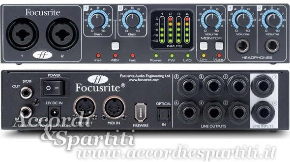

Hi,
The greyed out volume adjuster might be normal enough.
I know Motu grey mine out by default. I have to go into their control panel to enable system control of the interface.
I guess this is because they have hardware master volume controls. You're aware of that, right?
On the other hand, I've seen that happen when hardware is recognised but correct drivers aren't installed so...
Go here and double check you've installed mix control 3.5
I can talk you through checking which driver version is installed, if it comes to that.
There shouldn't really be any setup I'm afraid. Other than installing the manufacturers drivers and selecting the interface.
Navigate to audio/midi setup in utilities. Is your focusrite listed and selected for input/output?
Your monitors should be plugged into line outputs 1+2. At a glance I'd have plugged them into the wrong place....double check that.
Unplug one of the monitor jack cables at the interface and touch the tip. You should hear a buzz. If you don't your monitor isn't on, working, or turned up.
Hope that helps.
The main volume bar for my computer is greyed out and I can not adjust the master volume.
If that's your only issue, you should be able to just turn up the "monitor" volume on the interface and get sound.
Just to be clear, do you have studio monitors hooked up to the interface? Or were you going to try to just use the laptop's speakers? Because I'm fairly certain you can't use the built-in laptop speakers while also utilizing an interface, but I'm not positive.
I'm using the Liquid Saffire 56 and a Saffire Pro 40 at the recording studio I work at right now, so I should be able to help with most of your issues.
