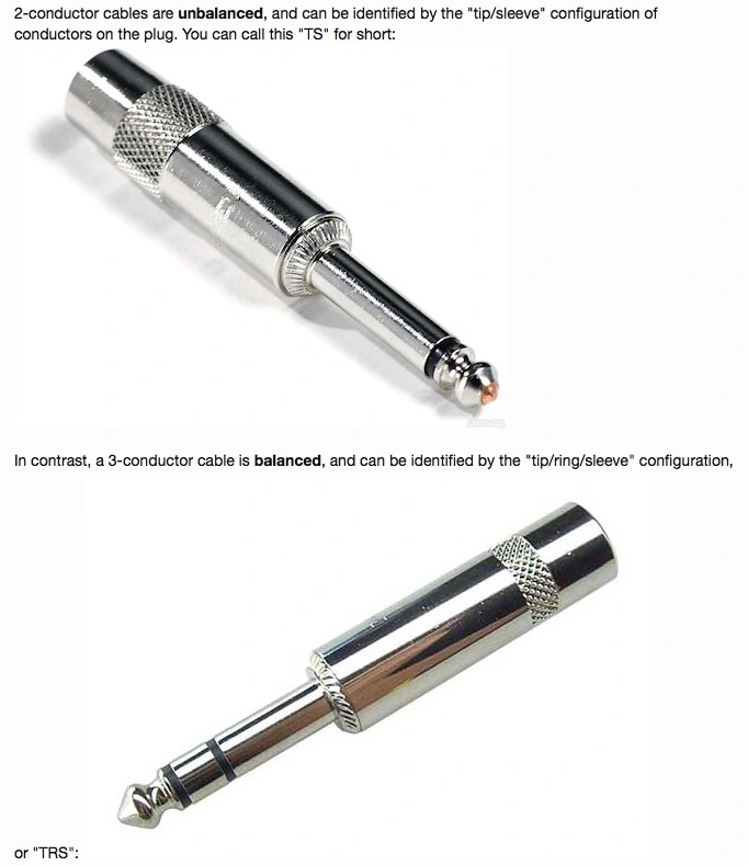

This screen shot might be useful.
Tip and ring only = no good for stereo.
Tip ring and sleeve will carry stereo.
The screen shot talks about balanced/unbalanced.
Different implications - same jacks.
