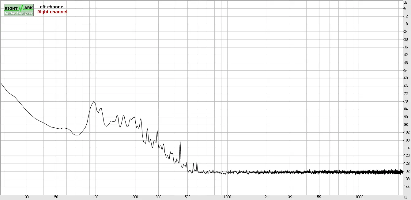

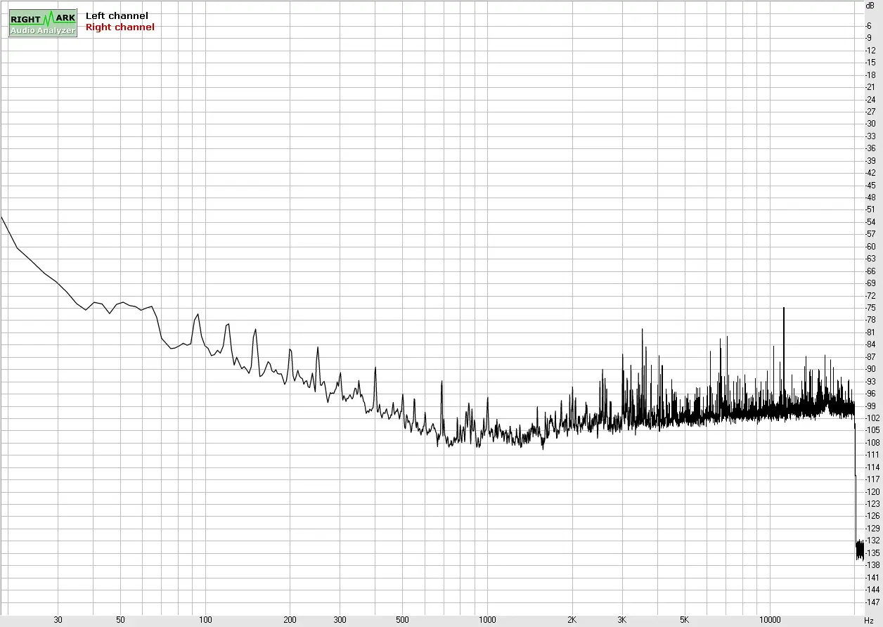

The spectrum "noise 3" is of just the noisiest part of the into but even with the "taps shut" the noise floor is barely better than -60dB. That is poor. The noise shown should be about 30dB bellow indicated.
The noise spectrum also shows the climb from about 1000Hz down? This usually indicates poor pre amp design.
As for a gating effect? the other specc' show that even with the guitar and voice low pass filtered out, the LF noise is still there so IMHO no gating is taking place.
Can you do a 10second run with the mic pre gains as set before but no mic plugged in and another with gains at minimum?
