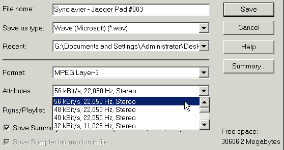

I use Sound Forge 4.5 while on PC and recently I have seen that when I want to save as MP3, SF offers as top rate no more then 22 Hz Stereo !!!
This is no burden or problem but I wonder why on earth and how this happened.
What I like when I record some radio interviews unlike others, Sforge makes MP3’s with flexibility - saved as clean Wav’s.
This way it easier and more clean for other programs to deal with this association rather then "mp3"
Audiograbber as others use external mp3 source , but Sforge relies on its own engine and this makes even less sense why has 44.1 option for MP3 disappeared.
Any hints?

Yes you can, at least in this version (4.5) you can.
I’ve captured save screen for you to see the problem exactly:
Always could save in any rate so far, but now only up to 22Hz.
