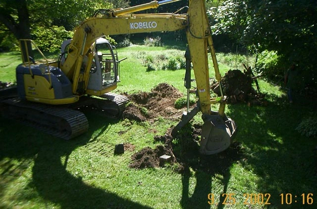

Hey Michael - way to go man, I'm envious. Still looking at probably a year away to ground break.
