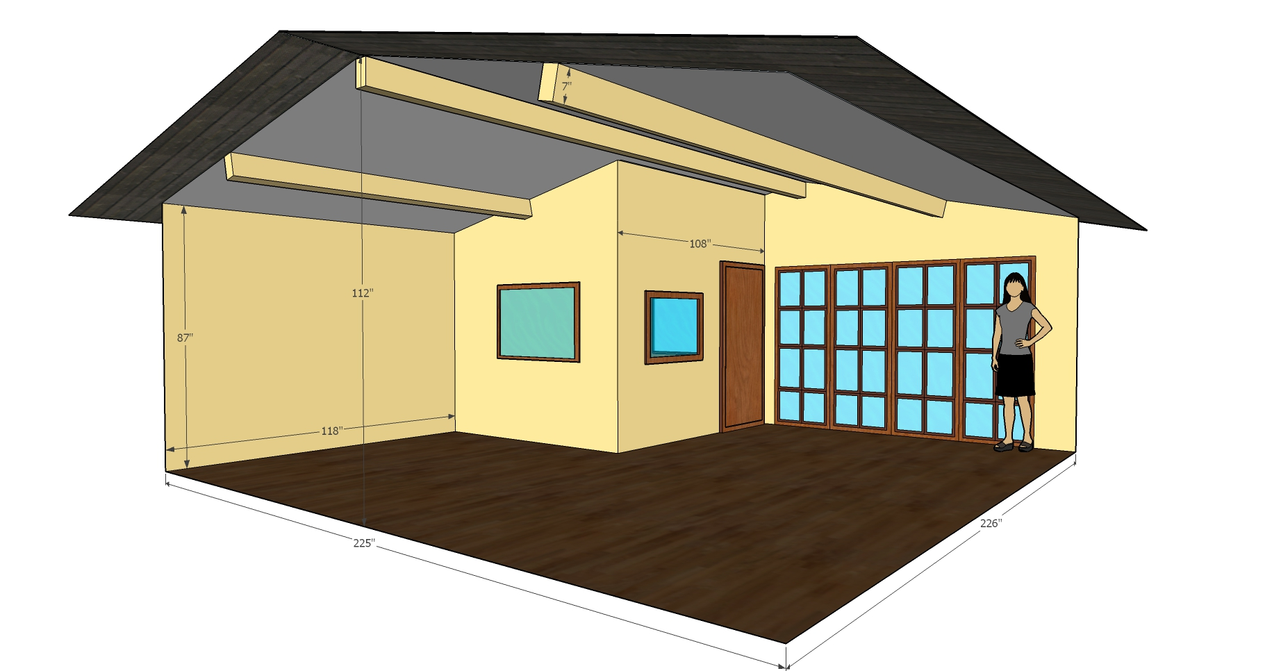

I've attached a jpeg of a model I knocked up in Sketchup to give a better idea.
It's basically a log cabin standing on a heavy duty concrete base. The cabin is made up of 50mm timber, 100mm slab, 2x22mm OSB board, 2x18mm sound Block plaster board, tons of silicone and... Mmmmm, textured wallpaper.
It has double glazed doors and window, 50mm gap and then secondary double glazing. It's a bit leaky, but I've no neighbours to worry about.
I've used Realtraps ModeCalc and if I was to take out the small room, leaving one big room the ratio sucks. (1:2.25:2.26) Cu Ft is roughly 2943 as one bigger room.
If I leave the small room in I'm stuck with the L shaped room, which looks challenging, plus the Cu Ft of that room is only 2377.

You are headed in the right direction. - Anyway, Modal calcs are only truly accurate for a rectangular cuboid that has a concrete shell and best utilized when building from the ground up. A larger, symmetrical room always trumps a good mode calculation.
