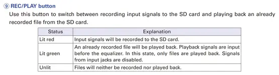

@bouldersoundguy Yes, page 5 of the user manual says that input signals are disabled when the channel is set to play but that is not my experience. To reiterate the input signal is always present unless the channel is muted or the fader is slid right down. The signal won't be recorded when it's green but that doesn't mean the signal is disabled.

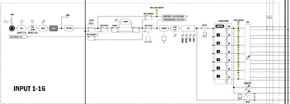

The block diagram sort of suggests that the 'REC/PLAY' switch can disable the path of the input through to the L/R master buss. However the is a software switch called 'REC SOURCE' that depending where it's set sends the input to the SD Card. What happens with the audio when it's sent to the SD Card isn't shown on the block diagram and I wonder if somewhere the audio gets back to an output buss to enable monitoring of the input(?). The 'REC/SOURCE' is in a menu where it can be accessed and changed and might be worth a try to toggle it to another state.
If the L20 is set for 96 kHz recording, it appears some monitoring and overdubbing functions change. If presently set at 96 kHz, try a lower rate. May not change things, but worth a shot.
There is an 'OVERDUB' button that I'm not totally clear on what that does and perhaps playing with either its ON/OFF setting may do what you want. Punch-in seems to make use of the 'OVERDUB' function button also.
The L20 is also intended as a live mixer besides being a recorder. If a channel is in either 'PLAY' or 'OFF' mode and the input signal did not pass through I'm not sure how that would be useful for a live mixer. For use as a live mixer the input needs to pass through somehow.

The REC SOURCE simply toggles whether the recorded signal is pre or post compressor. That would be a weird way for the problem to be solved but I'll give it a go.
