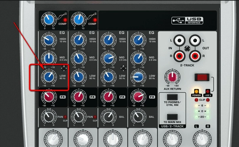

High pass filter on a mic or preamp is one that cuts the low end. The mixer doesn't have a switch, but does have EQ that can do similar.
I think that a high-pass filter totally cuts off only lower frequencies, while EQ lowers their volume in a less defined way - I don't know about this specific EQ, but I think it affects frequencies around 80hz, which has a different (more noticable) effect than a simple high-pass filter. I gotta find more samples though - maybe there really isn't that much of a difference in the end. I would still like to know a way to add live software effects to my mic input.

That said, the 80Hz frequency specified on the mixer is a reasonable point for the filtering--but obviously it depends on the filter slope whether you can actually use it as a high pass. As usual, Behringer is a bit sketchy on the details.
