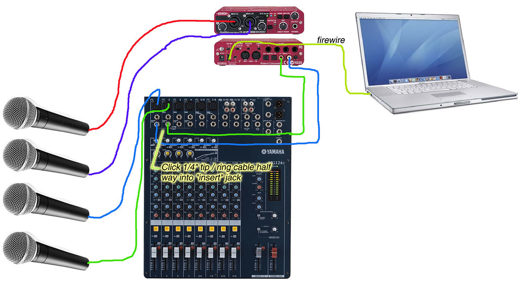

Hey Cap'n.
I just looked up the equipment you have. Looks like your card can handle 4 discrete inputs- although it looks like inputs 3 and 4 are rca plugs on the back of the unit.
You should be able to record 4 separate mics to 4 separate tracks with what you have.
One option...
mic > edirol channel 1 > computer software track 1
mic > edirol channel 2 > computer software track 2
mic > yam ch 1 > edirol channel 3 > computer software track 3
mic > yam ch 2 > edirol channel 4 > computer software track 4
to connect the yamaha channels to the 3 and 4 inputs on the edirol you'll need cables with a 1/4" tip / ring on one end and an rca on the other end. Take the 1/4" end and click if half-way into the "insert" jack on the mixer. this should take a signal directly after the pre-amp and before it gets to the eq and fader.
As another option, you could do the same thing but run everything through the mixer, so you run each of 4 mics into the mixer and route like the 3rd and 4rth mic in the example above.
The problem then is, what 4 things you'll mic if you are doing a whole band at once. You'll have to do some experimenting here.
We normally record my band during practice- we'll use 4 mics for drums, 2 mics for guitars, a channel for bass and 3 channels for vocals. Thats 10 channels and I'm trying to add a few more so I can get mics on toms...
Sorry for the book. Hopefully you can extract something useful from that.
See if this helps at all...
