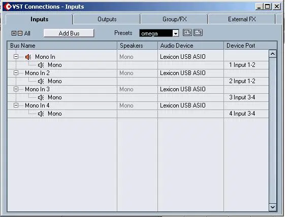

thanks SheHad....... thats what i kinda figured. So basically i cant record simultaneously and output four seperate instruments to seperate tracks in the software correct?? its more like bass and guitar= track 1, vocals and acoustic guit=track2 ??? i guess i gotta go with like an Alesis firewire?? :confused:
No. you can record 4 mono channels simultaneous.
What i meant was (somewhat confusing), that its possible to record several instruments in one track.
But the purpose you are looking for is possible (if you can do with mono).
Check the attachment

that visual did help alot SheHad. So 4 simultaneously can be done but, say the guitar will only sound on the left side, vocals only on the left side, bass on the right side, and acoustic on the right side?? If so, i guess i have to go with a firewire device :confused:
On the bottom of the mixer below each track, where your BUS is, you can set left or right on each track. You can set right, left, or juggle them around. You could have guitar, vox and keys on right and drums and bass on left...or drums right and guitar, bass, keys,vox left. Plus the panning at the top of the track in the mixer if you want that more centered...etc.

but would each instrument be able to be centered individually if needed? i just want 1 instrument per track, i guess for a total of four tracks showing in my DAW, if i record them all simultaneously
I use the panning at the top of the mixer to center or go more right or left. I am most likely confusing you. They are all seperate tracks, but I can never get four, only three. I am sure it is me screwing up. I am still learning the Lexicon-omega with Cubase LE.
i'm still pretty much a newbie with all the technical aspects of recording. I thought that if a track is "mono", the sound would only come out of the left or right side/speaker?? no matter if you set the panning knob to the center position?

In cubase if you record in mono, you will get a mono track, but it will be centered (not just playing left side or right side). This mono track can be panned. (i would give you another screenshot, but im not at home right now)
