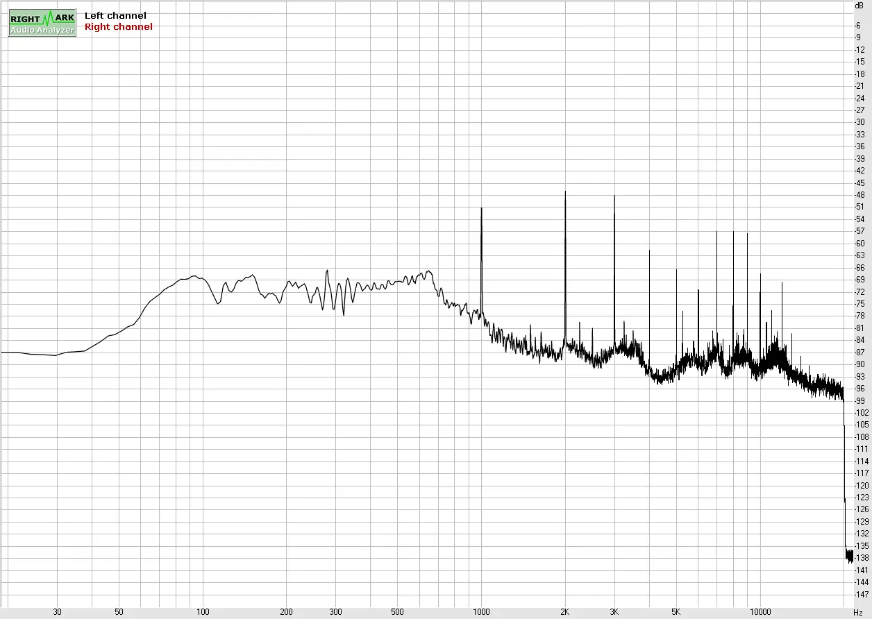

I realize this was recorded from your phone, but with a spectrum analyzer I see spikes at each 1k, 2k, 3k, 4k, 5k, up to 10k.
Not something I have ever seen or heard. :eek:

No, I don't think it is a ground loop either. If you varder the spectrum you will see spikes at 1,2 3,....kHz but nothing in the LF area.
I suspect the recording level is slammed at 100% in Windows sounds. I don't know if ASIO drivers are available but if so, use them and then level control is out of Msods hands AFAIK.

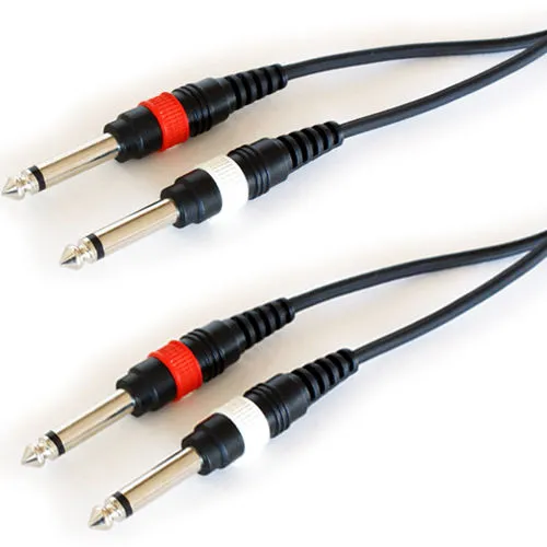

Thanks again for all of your replies! I've solved the problem. I've connected the HA4700 via the 'line out' of the lambda using 2 mono 1/4' mono plugs on both ends of the cable. So now i have 5 headphone outputs :D (four on the HA4700 and one on the lambda)
