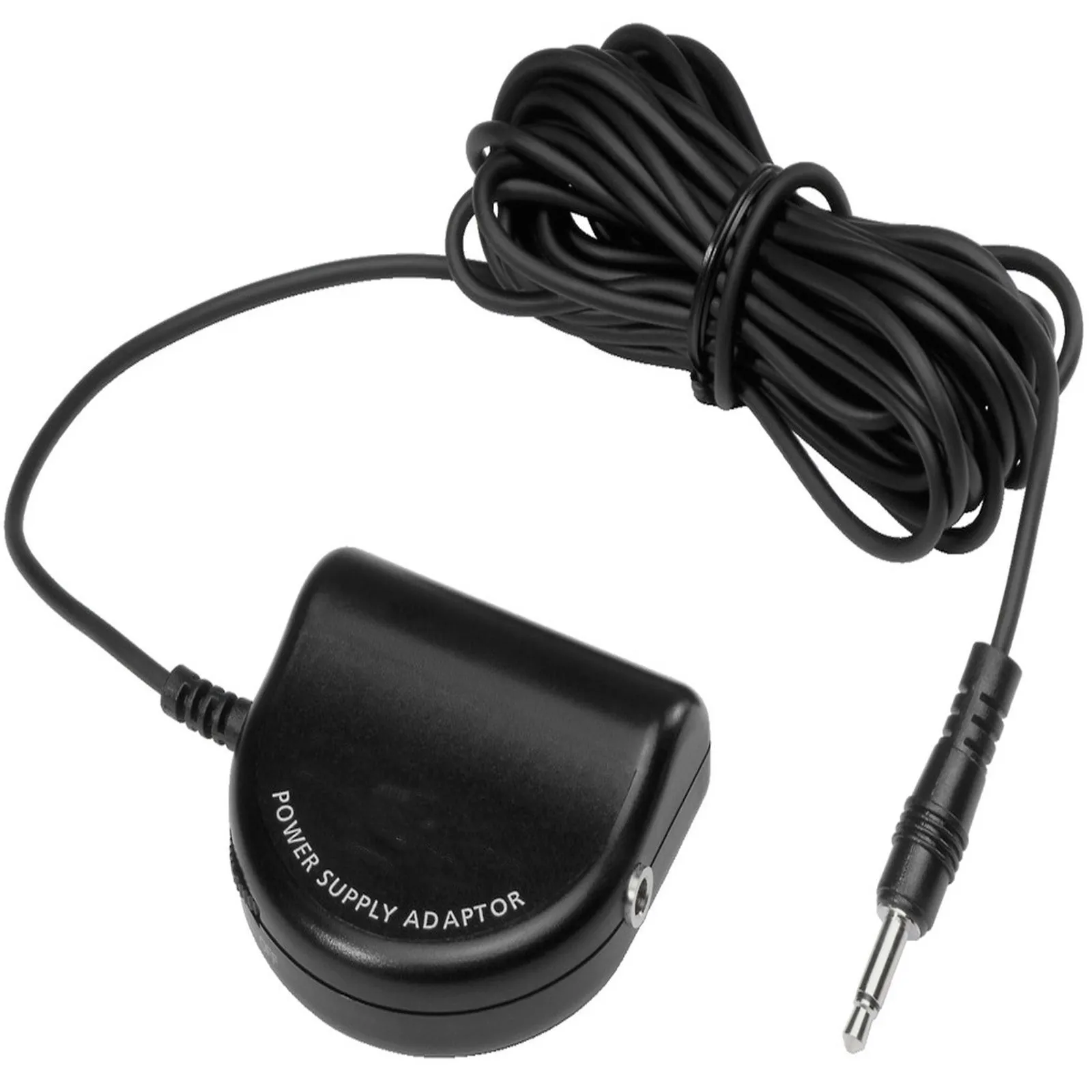

- I bought two of these inline mono power supplies 3.5mm MONO JACK PLUG IN POWER SUPPLY BATTERY MODULE FOR ELECTRET LAPEL LAVALIERE | eBay
This solves the power problem

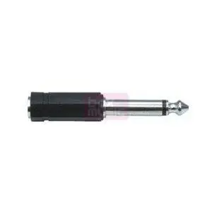

- Then you need adapters to connect the two lavs to the sockets in the base of the H4N.
https://www.bax-shop.co.uk/jack-jac...-jack-female?gclid=COm884_s5s8CFYIV0wodD5AIVw

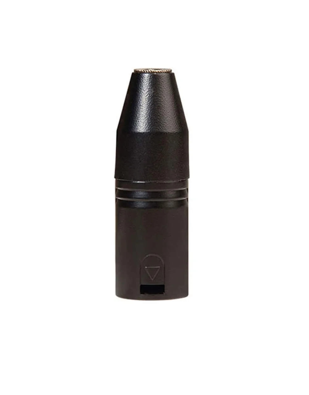

I also bought some of these, which I imagine should work... but for some reason that I haven't yet fathomed, in practise they don't!
https://www.amazon.co.uk/dp/B000Y021NA/ref=pe_1909131_77697001_tnp_email_TE_AMZLdp_1
So, keep it simple, buy the jack adapters above, which are way cheaper anyway.
