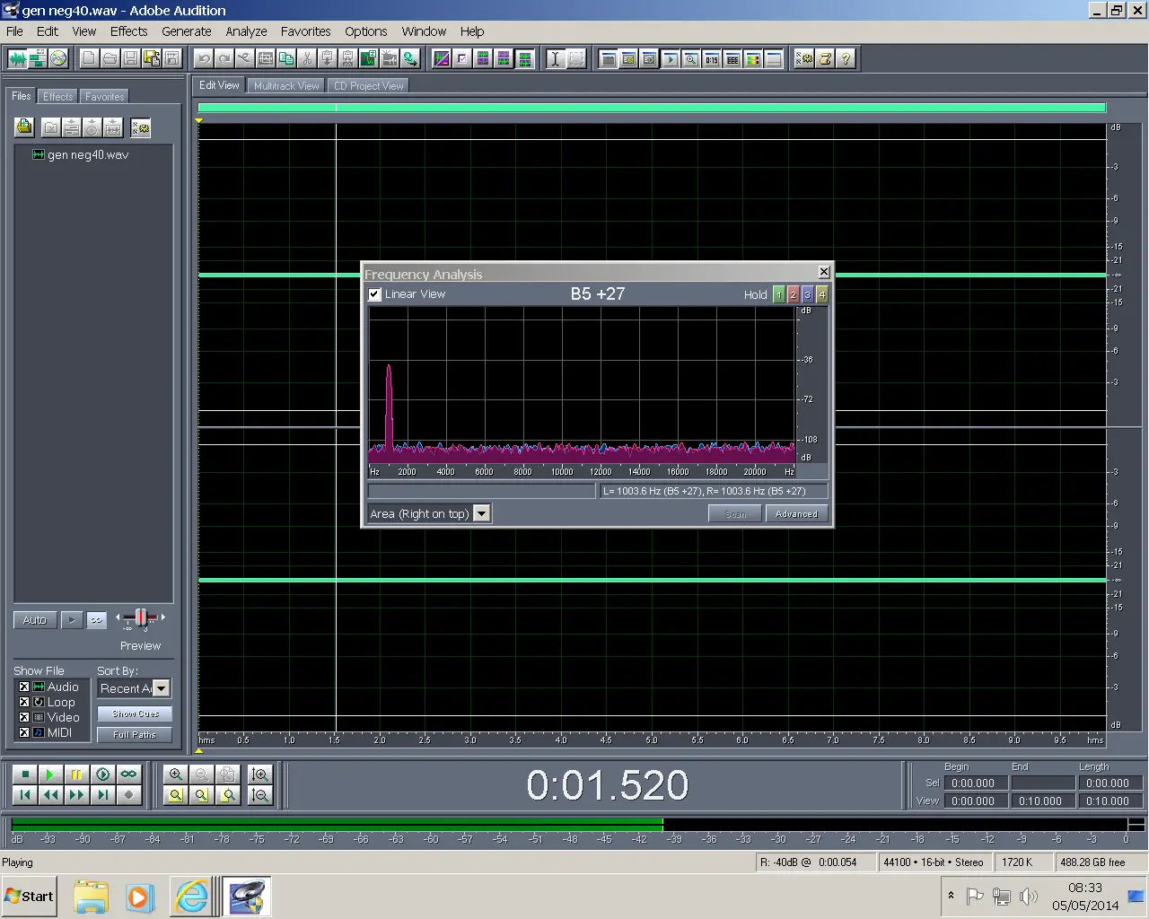

Attached is a spectrum I have just run of a generated neg 40 1kHz .wav and you can see that there are no artifacts above about -100dBFS. I have just done this on a new Asus MA97 MOBO with an AMD 6 core 3.5G CPU which I have built to replace my old P4 XP machine. I have taken no special precautions, just plugged in the 2496 sound cards (there are two) and Bob's yer mother's brother.
I WILL agree that the PCI card has had its day, a bit and there are many very good external USB AIs now about but if you happen to have a decent mixer on hand(I do) a PCI or PCIe card is a very viable option.
