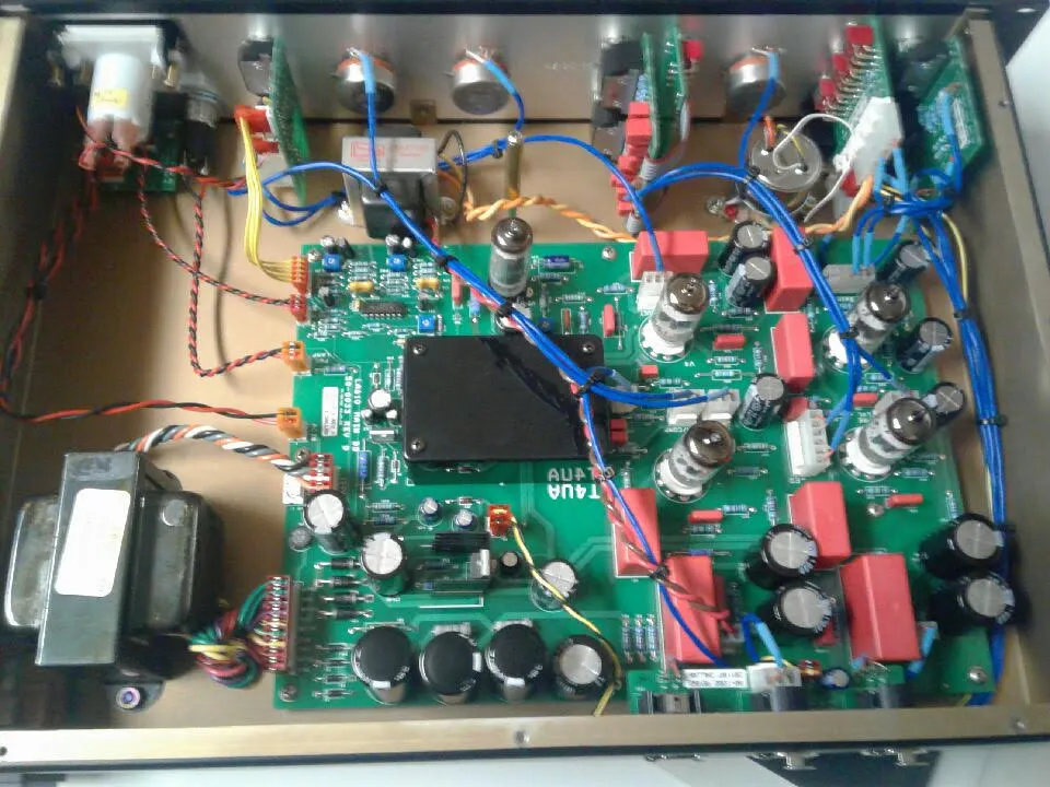

LA610 SE arrived and popped the lid immediately, WIMA's and Cinemags, and Phillps GE tubes in all slots.....what kind of genius's can design and build this stuff?

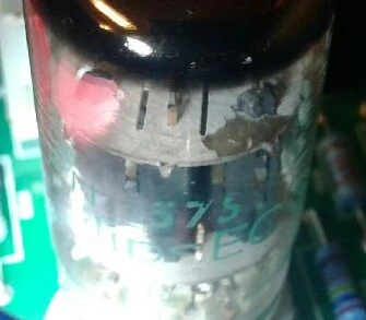

Being anal I did notice one tube looks to have a oxide? flake off its plate?

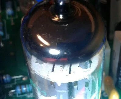

Heres picture of the "plate oxide flake?" and a good tube...see the white is not there on one of the tubes (pre Level tube)
Any tube experts think this is a problem?

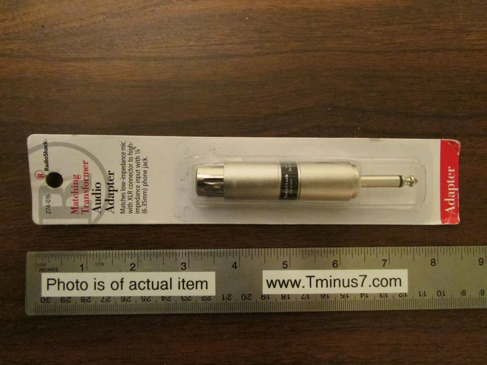

1)Initialy plugged the LA610 Line Out to Interface Line IN with a XLR to T/S cable and was getting a very small weak wave on the Reaper track. It did sound barely ok through the headphones. Playback was so thin I thought "defective! unit a ripoff!" lol or the tubes were burnt out$$ etc....defective!!.:eek:
2)Trouble shooting I tried LA610 Line Out to Interface Mic In, with a XLR/XLR cable, mucho louder but sounded bad. The LA610 manual states "Polarity moves the Hot from Pin to Pin on Line Out if using T/S and not TRS." so I tried # 1 again, Line Out to Line In..
3)Went back to Line Out to Line In config with a mic cable XLR/XLR but added a Radio Shack male connector I had in a drawer, which gender changes XLR to 1/4...because I didn't have a XLR to 1/4 TRS.
It works normal now and its louder, much louder and totally different, huge difference in volume and full sound and the Reaper Wave is controlled to be larger or smaller as I turn the big black Bakelite Gain knob. very cool...
Im not sure why this Radio Shack plug, mic XLR to 1/4 helped so much? Is the LA610 Line Out and the Interface Line In some major mismatch? Was my cable bad? Radio Shack p/n 274-016 LowZ to HiZ. Adding this thing was a huge difference. So huge I didn't think the unit is faulty now. whew!...
Radio Shack is a Z changer of some kind. Whats going on with the transformers? Will a normal XLR to TRS work as well or do I need a Z change?
I think you're referring to the mica insulator that electrically and physically holds the elements of the tube. A bit flaking such as shown shouldn't be of any concern. Mica is inherently a layered flaky material. The plates are the darker gray structures in the tube.

thanks, interesting. Mica the Insulator.
It seems to work. I ordered a spare, it will cover all 3qty 12ax7 if needed. I have a hunch these tubes are the original from 2008-09 or so...

man Im confused, went and bought a TRS cable and there was hardly any volume from the LA610 to the Interface and the Reaper wave was barely seen. as before with the other TS cable.
But when I used the radio shack impedance thing, the volume was full and loud and all seemed good to go.

2) I asked why does adding the Radio Shack LowZ to HiZ TS connector quadruple the volume? then its almost too loud...unbelievably hi-gain and cleaner and full.
But I shouldn't need the Impedance thing,right?

Its weird the RadioShack Impedance plug quadruples the volume?
I don't understand that at all either.

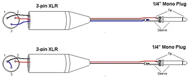

I went to Line6's site for the specs for the UX8. Line inputs are 10kohms and that's OK, but the specs state the line ins are 'unbalanced' which is intended to take a TS type plug (this sucks cause you'll lose about 6dB signal vs balanced). You mentioned trying an XLR to TS cable. Do know if this cable is wired to 'convert' the balanced XLR connection to an unbalanced TS? It likely is wired to do this, but maybe worth a check. It needs to be wired so pin 1 and 3 are tied together and pin 2 is the 'hot' (see image below). The Radio Shack adapter does the balanced to unbalanced thingy and because of the transformer it may give the signal a boost, but may alter the sound as well.
A cable that does balanced to unbalanced ....... Unbalanced Interconnect - Hosa Technology

wow, thanks for that.... I'd buy you a beer if you were here! how did I overlook that? I assumed the 1/4" was the TRS style! on the Line6UX8.
the radio shack transformer/impedance thing is TS....not TRS, so maybe that's it. it makes sense.
I need to double check but the LA610 is +4 out, and it mentions its ok to run into a mic pre on a interface IF it has a pad, if not they really recommend the LINE IN on the receiving interface.

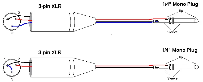

OK I found a XLR to TS cable, Pin 2 is hot, 3& 1 tied together.
So its better to float 3? or leave it on 1?
I'll try both. The same cable from my ART balanced out to TRS to UX8 Line In isnt having the same issues.
Leave pin 3 tied to 1. The ART is likely 'electronically' balanced on the output (no transformer), which may work OK with TRS. The LA610 I'm guessing has a true transformer output and if the ring of a TRS plug doesn't make a connection to ground inside the TS jack of the UX8 to complete a low side connection of the 610's transformer, then one side of the signal sees an open circuit and won't work well.

arcaxis....dude...you found the root cause. and theres some funny ironic extra notes in hindsight.
the very first cable I used was a XLR to TS....but I found out just now with my meter pin 3 was floated (it doesnt work on the transformer output LA610).
after you mentioned this I found another XLR to TS but it was like a homemade one from years ago that had 3&1 tied.... it came on like a healthy, loud, everything perfectly fine system now.
the line6ux8 non-balanced Line IN and the LA610 balanced Line Out was a "bad match". It ONLY works with the pin 1&3 tied together. and exactly as you said, the LA610 doesnt like pin 3 floating.

add> Weird wiring.... that Radio Shack thing ohmed out pin 2 was the tip as normal, but the 1&3 were not connected at all to the shield to pins 1&3 measured open.
Looking at the transformer drawing above thats right, theres no connection other than the transformer?
that thing increased the volume but adding a noticeable hum in the 100hz range, a bad buzz hum.
