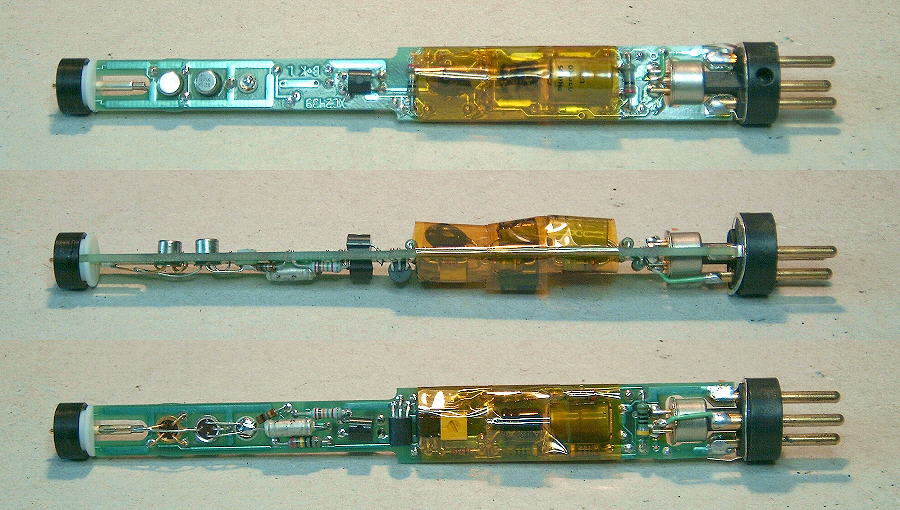

in the picture the top left large device should be a fet center leg gate, note the nice design of the PCB with the cutouts to isolate the high resistance section of the board.
