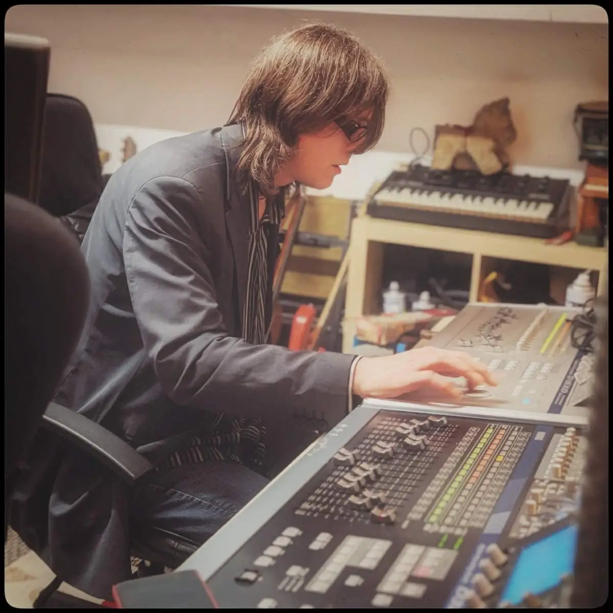

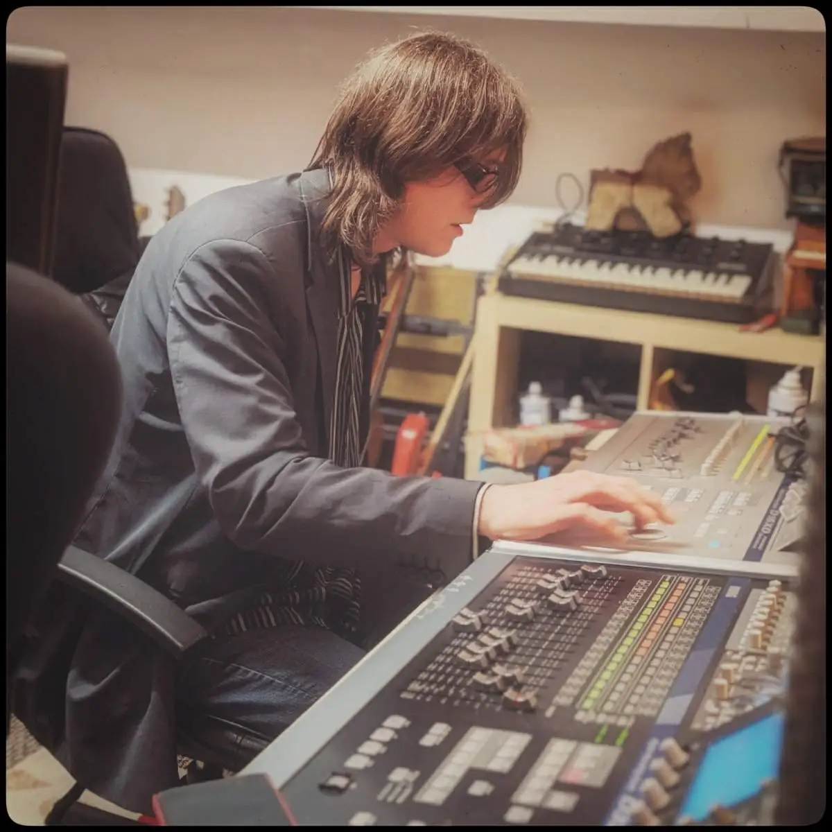

Ahh, Raymond! Reminds me of the good ol' days on Soundtrax.... waiting to see if Korg had really abandoned those of us who'd spent thousands on em... yep! Are you sure it's safe to run without those fans....? I've always been concerned about the heat from the hard drive, tubes on the TPB-2 etc... as well as those rather large chips. I was just about to replace both the fans in mine this week, but, heck, if if you think they can run without!? Have you checked the operating temperatures without them (whilst using maximum amount of inputs/processing)?
Such a shame Korg abandoned it's customers (and since the pandemic you can't get ANYTHING repaired or serviced outside their 12 month guarantee!) as they just needed a few tweaks/additions to the OS - varispeed (to compete with the DPS24mkii), some more work on the pretty crappy DSP reverbs - and some possible hardware/board upgrades; maybe an external monitor/USB2.0 module; not too much to ask for a machine costing $5000..? Nope. I was quick to buy all the modules (really cheaply, mostly in sales after the discontinuation) having a D32xd and D16xd, fitting DIB-8s to both. Consequently, having those 8ch of ADAT i/o, both are still at the centre of my control room (AIB-8/ACB-8 in the D16xd, TPB-2 int'other), running in 2xStereo>MOTU Ultralite, synced via ESI M4U EX and a Midi Thru box... if I need to to bang all 32 tracks over to Pro Tools etc I can switch to the ADAT outs, four passes (and a bit of fiddling/routing), done. The reason I kept them? The pre-amps.
Personal upgrades..? Impossible. Tried every possible IDEtoSATA adapter route to stick an SSD in there (thought I'd cracked it with an MSATA 2.5"caddy with IDE pins>2.5"to3.5" adapter... looked like it was going to format for about a minute aaaaaand... shazbat!) Best thing you can do is pick up as many nos 160GB IDE as your arms can carry.
I dream that one day some clever dick will have the brain to crack open the OS and develop it a bit further. We can but dream.
