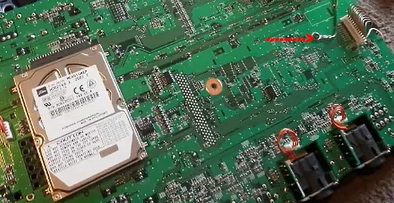

Yeah, I think I've seen this before, but thanks, cuz I took a good look this time, and it appears the hard drive's pins plug directly to the board, NOT to a white plug at the end of some wires, a plug that's about half the length of that double row of pins on the drive. My original post a day ago (you'll see 3 attached pics) is asking for help with plugging that white plug into the correct pins on the drive, cuz I mistakenly thought the plug went into the drive's pins. But now it's pretty obvious, after looking at the video you attached, just where the drive plugs into. So thanks!
My original post:

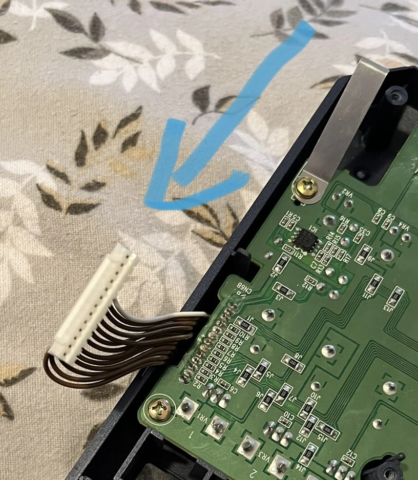

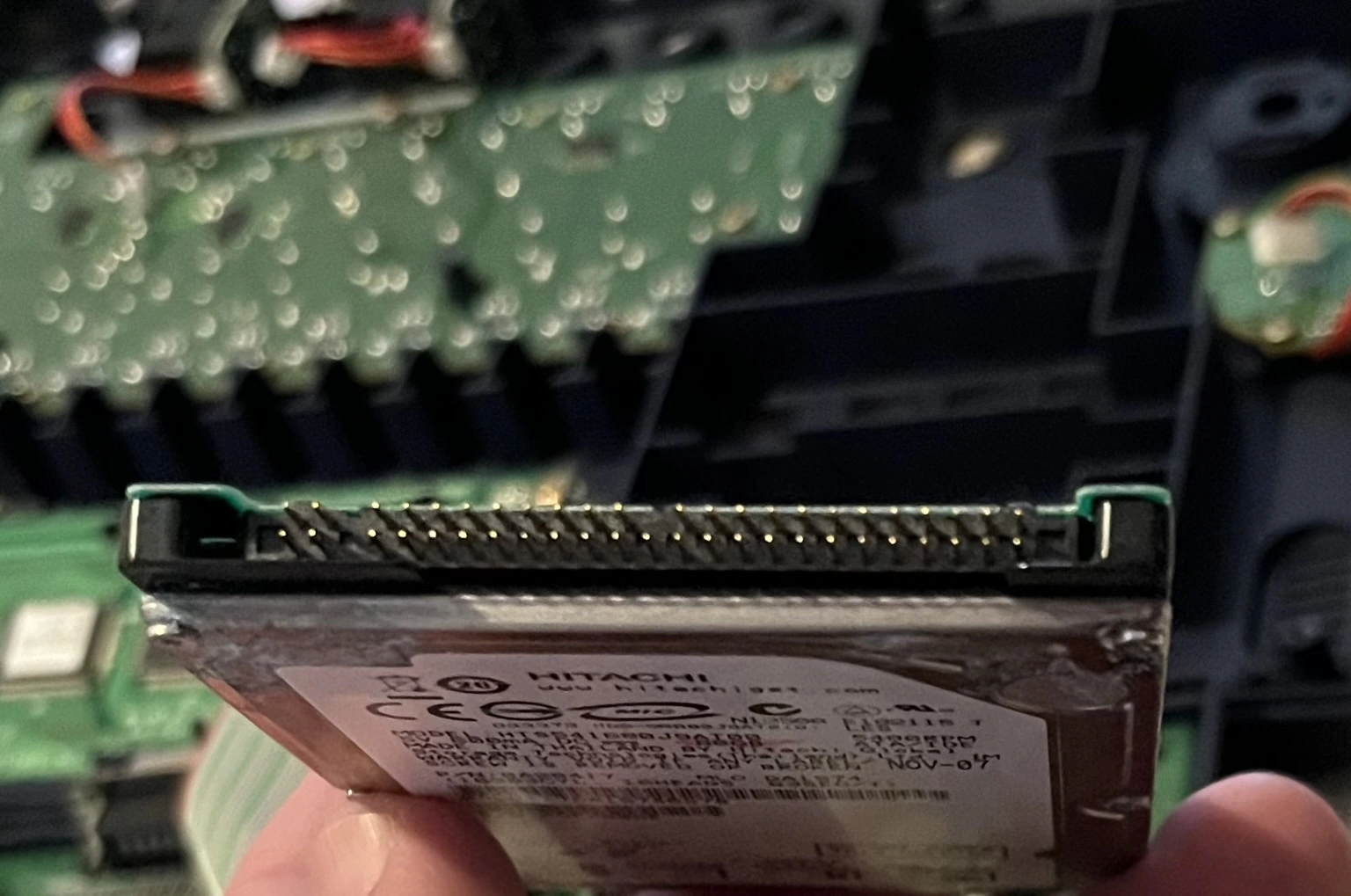

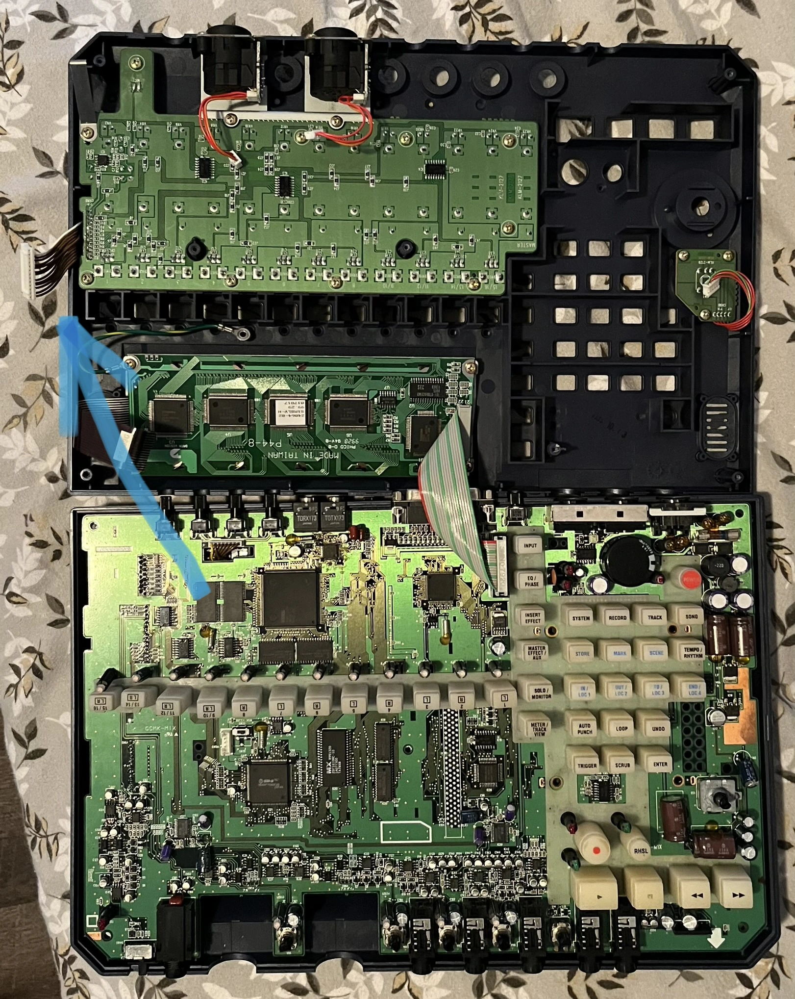

New to this site, but really need someone's help. I have a Korg D16 that's disassembled, hard drive out. Years ago, on an identical D16, I replaced its factory 2.1G drive with a Toshiba 60G drive. Initialized, worked fine, for years, not a single problem. I think I had upgraded to their 3.1 OS. On my second D16 I started disassembly and removed that factory 2.1 drive... and stopped there (long story!). Someone was holding both D16s, but unfortunately the working, fully reassembled D16, with the fully functioning 60G drive, went missing. So I'm left with the D16 who's drive is out. I have everything: power supply, all boards, knobs, screws, connectors, and the 60G upgrade drive, like new, sealed in original foil, no reason to suspect it won't work.
PROBLEM: I can't be sure where all the inside screws go, cuz I took it all apart years ago, and without the second, fully reassembled D16 in front of me (the one that went missing) as a visual guide, I can't possibly reassemble everything exactly as it's supposed to be. Any suggestions? But even more problematic for me is attaching the connector to the pins of the new drive (see 3 attached pics). You can see the connector is about half the length of the row of pins on the drive, and I remember having to plug in that connector to just the right spot, to just the right pins, for it to be installed correctly. I got that info online after a pretty long search (cuz Korg's tech people were telling me swapping out drives was not possible..."proprietary" hard drive, etc.), and when I installed it exactly as instructed everything worked great. But I can't remember where I got that info so many years ago, so, good people, any help with my issues here is GREATLY APPRECIATED. Thanks!

Search for 44 pin ide pinout.
That little connector is not big enough for a hard disk.
The little connector just off the left of the top picture looks the right size to connect with the connector in the second picture.
What's on the underside of the lower board in the top picture?
There liiks like a hard disk sized interface under the button '2'.
Ok, I tried posting a link to a pinout picture, but it didn't work. Just do the search.

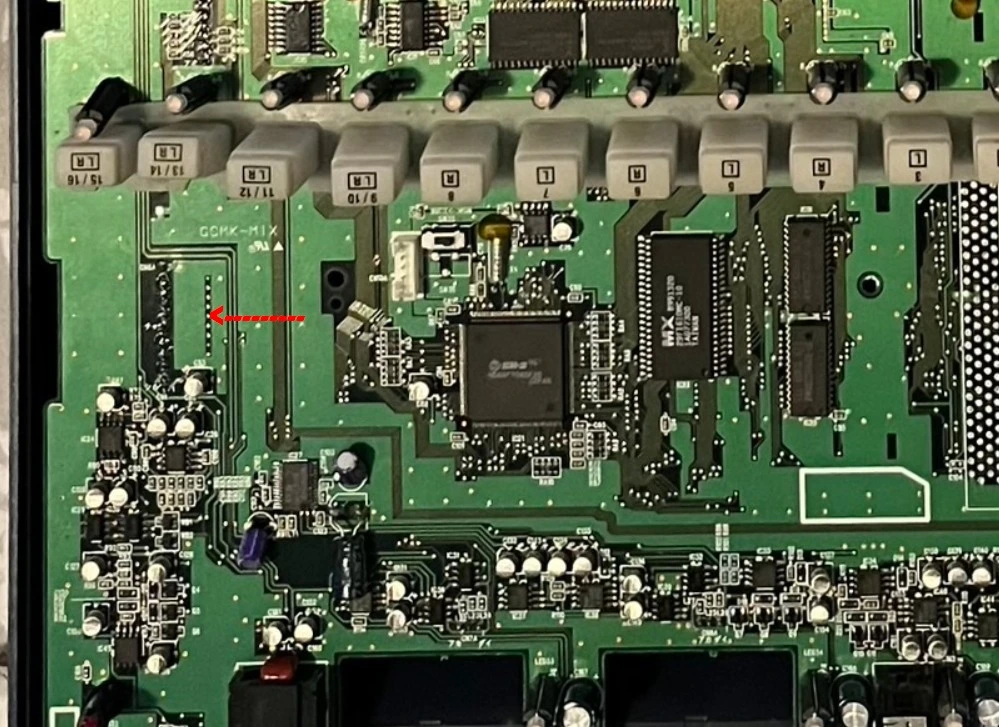

That connector doesn't go to the hard drive, It appears to connect to pins on the underside of the board. This is the same connector you show. Is there a row of pins on this side of your circuit board?
Looking at your board, I think you have to get to the underside. This looks like the header is in this spot on your board.

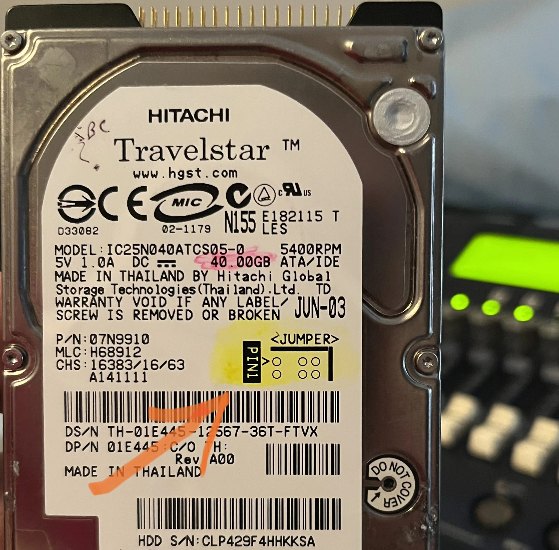

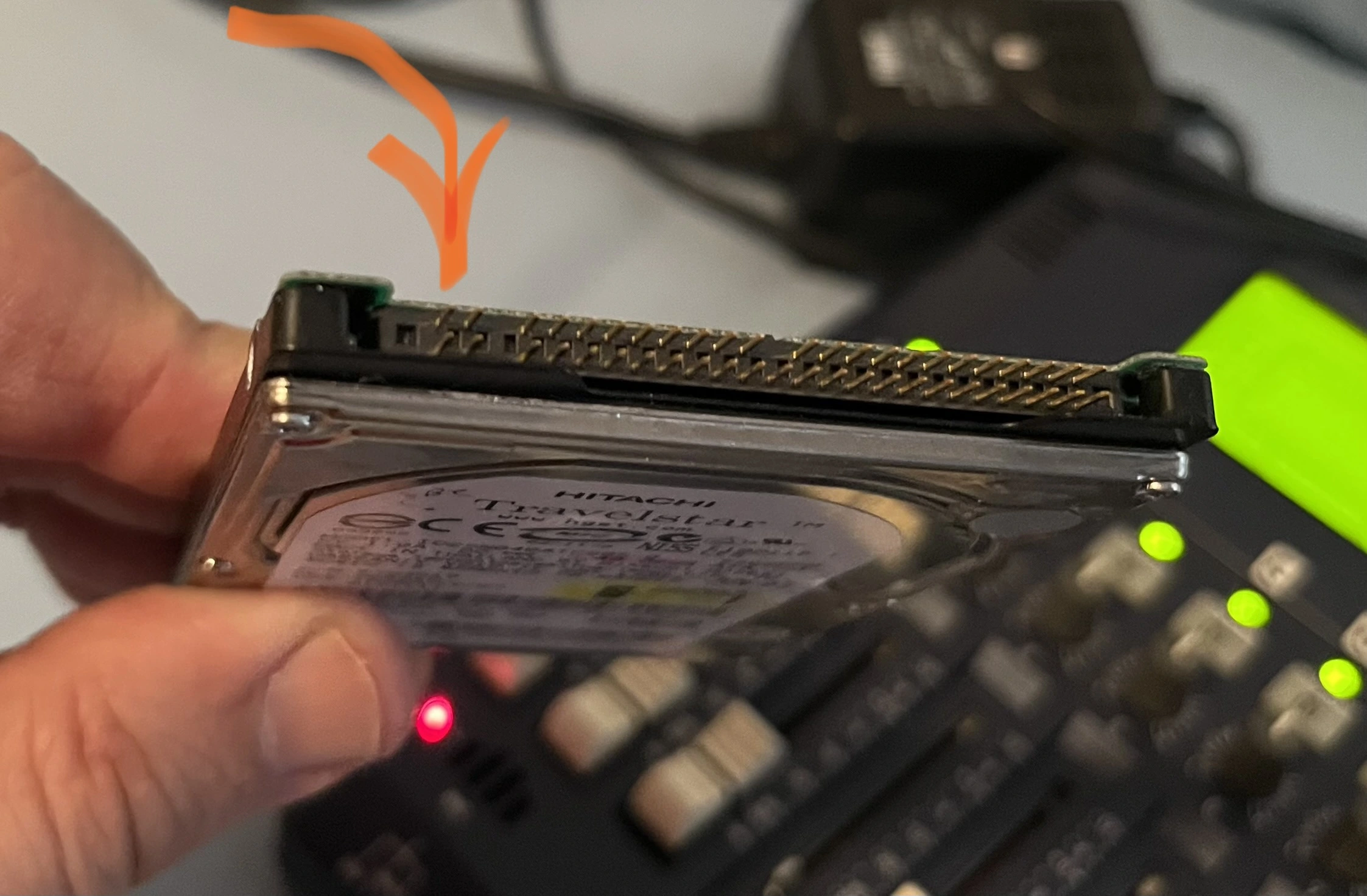

Please see the 2 attached pics:

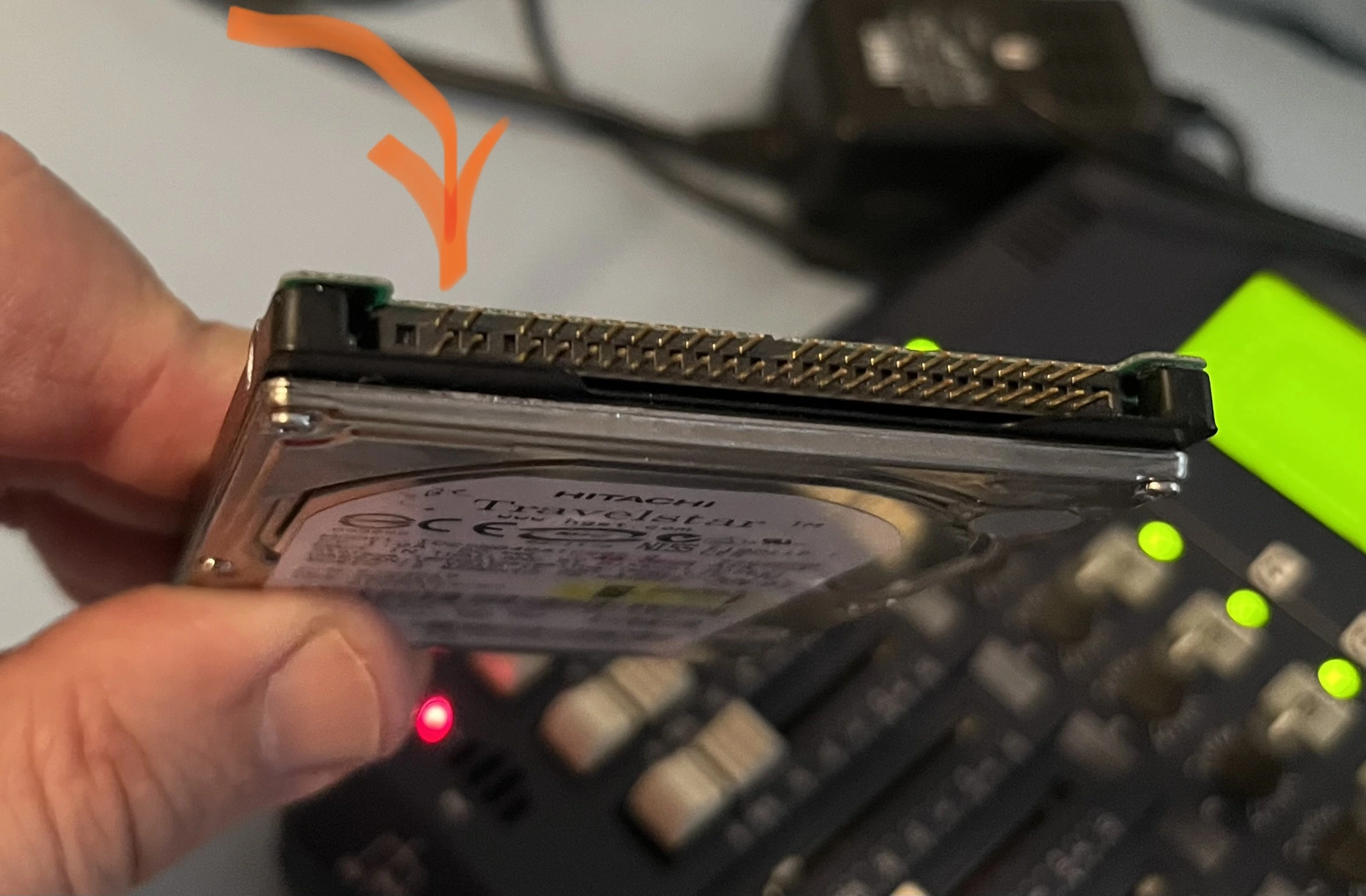

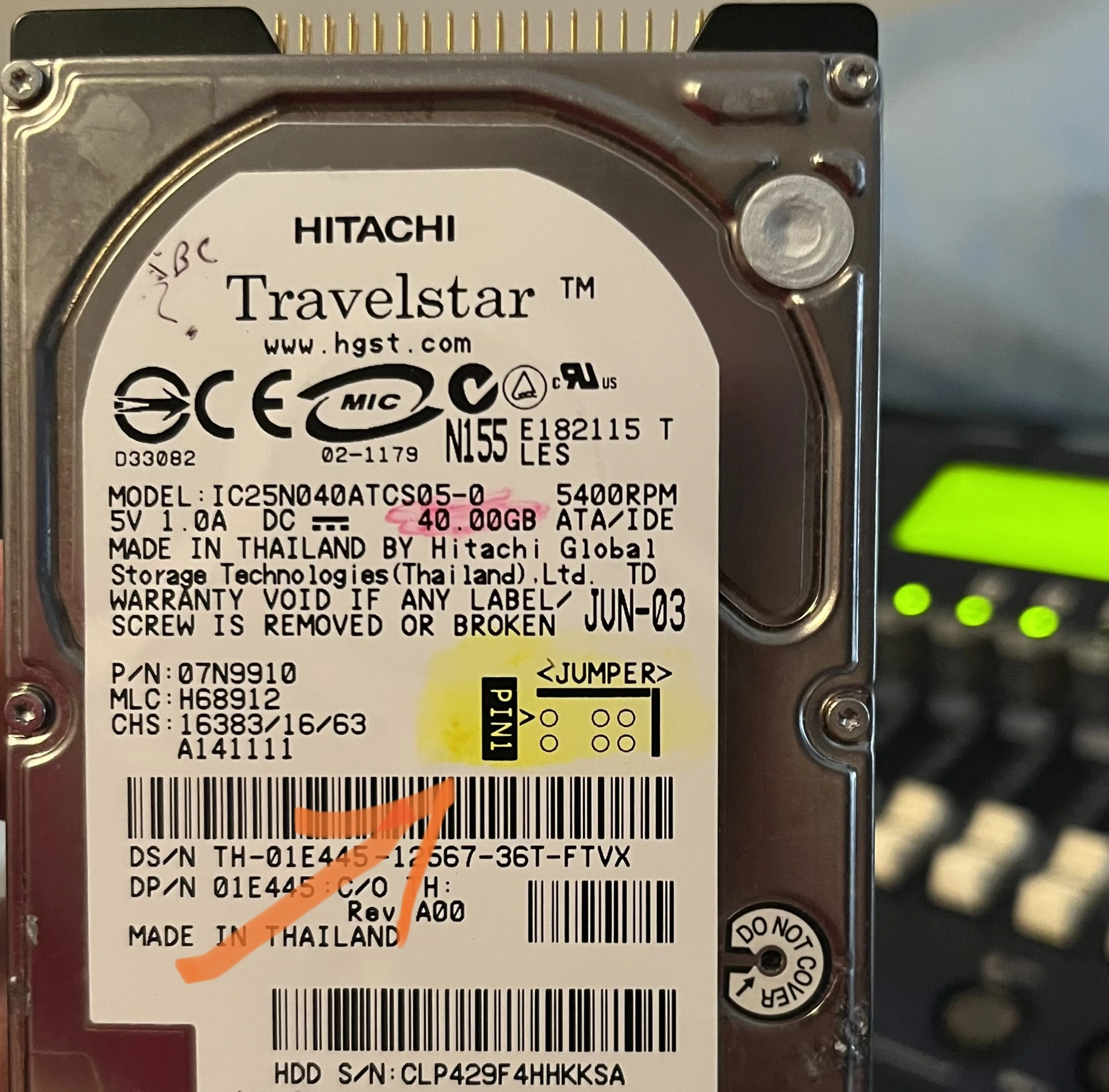

This Hitachi 40G drive (once was installed in my D16, worked flawlessly) shows a <JUMPER> diagram indicating a PIN1 location. Those 4 pins isolated on the right of the diagram correspond to the left end of the pin array of the drive itself (with the drive's label facing up), and shows the relative location of PIN1. The factory-installed 2.1G, this 40G, a 60G and an 80G, all of which at one time or another were installed in my D16, and all of which worked perfectly, I assure you ALL 4 have the same exact number and arrangement of pins. (See second pic.)
I mention all this cuz I have a memory from all those years ago of possibly having to utilize those jumper pins and pin1 in some kind of way. A guy on a Korg D16 forum (I believe he was from Ireland, the "manager" of the site?) back in '02 & '03, was telling me I had to do such-n-such with those jumper pins to get the drive upgrade to work properly. But for the life of me I can't remember the details, but I remember I took his advice, and the upgrade workd fine.
The 60G I just installed has been initializing for well over 1 hour now, with no change, and I can't help but think it might have something to do with me not utilizing those jumper pins on this upgrade.
Any of this sound familiar to any D16 owners? I'm not sure it's such a good idea to leave it initializing for so long.

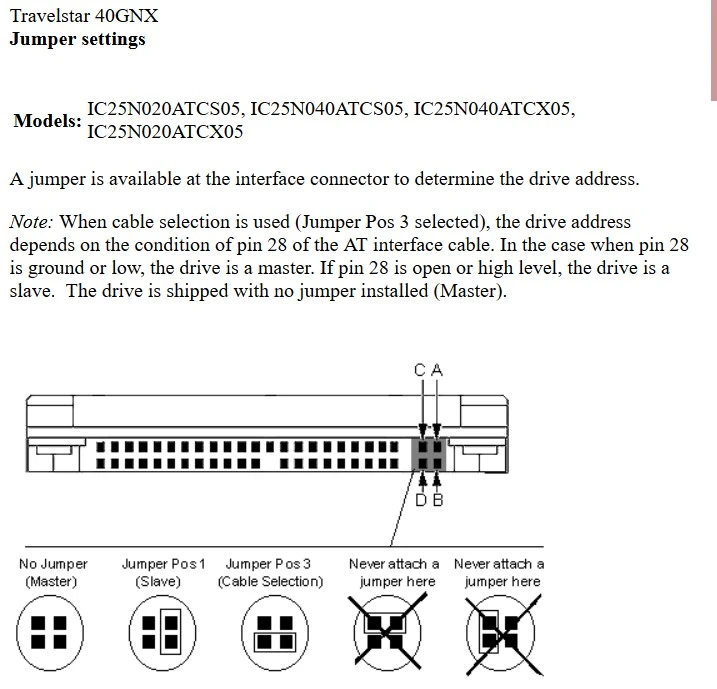

The key is that you have an IDE drive, which needs to be set as either a master or a Cable Select drive. I don;t know how Korg set up their hard drive system, but this is how to set the jumpers for the Hitachi Travelstar drive. The Pin 1 designation is for the IDE cable. IDE cables have a colored indicator on one side of the ribbon that indicates that it is #1. So the colored side should set to pin 1. The 4 pins on the end are for the status of the IDE drive.
If you installed it without any jumpers (set as Master drive) and it isn't working properly, you could try Cable Select. Slave setting is for when you have two drives, one is the master and the second is slave. With a Cable Select setup, the signaling is set so that the computer sets one as master and one as slave automatically. So you either want to set a jumper between pins D and B, or have no jumper at all. Putting jumpers across pins A and B sets the drive as slave and it won't work.

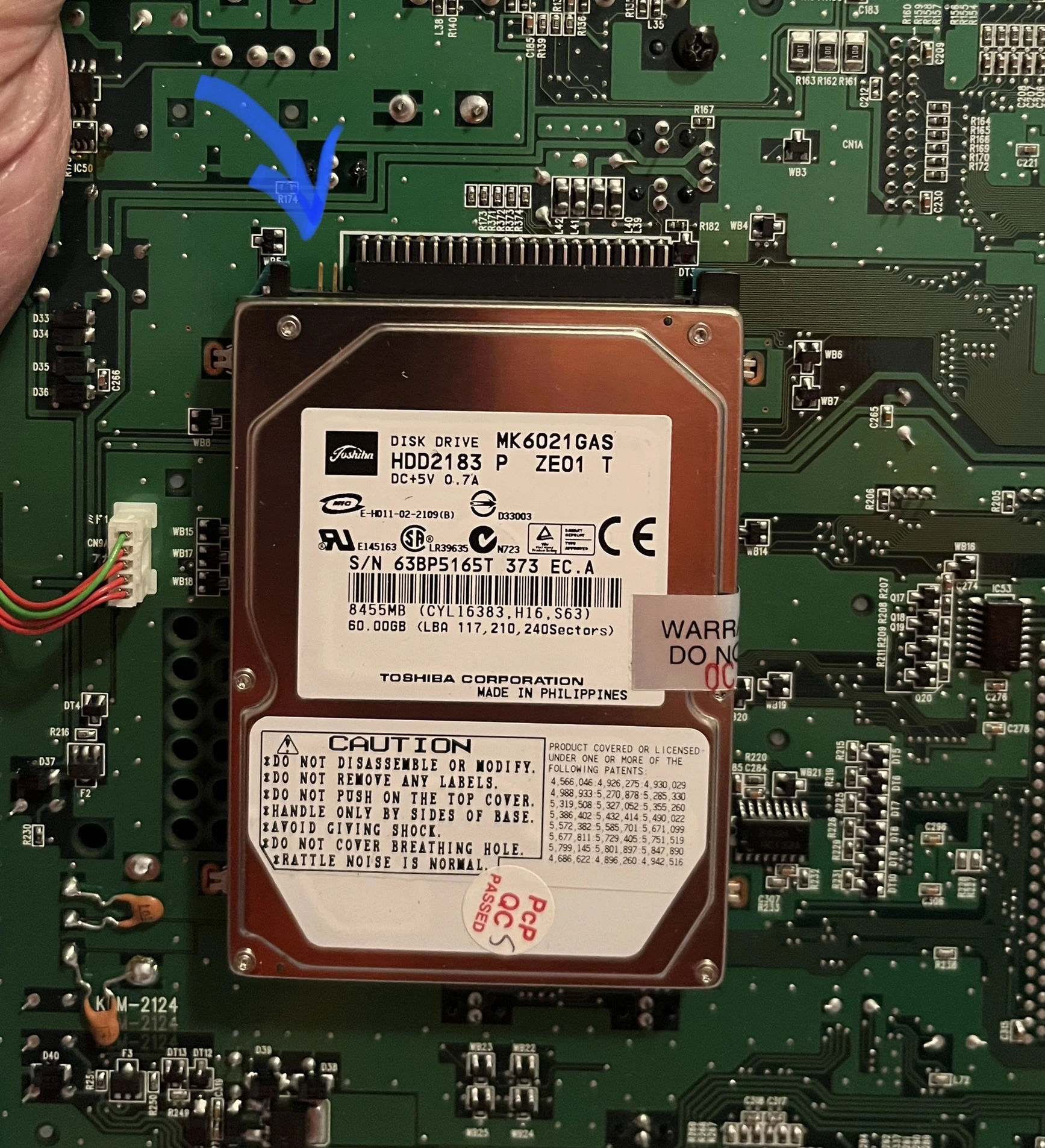

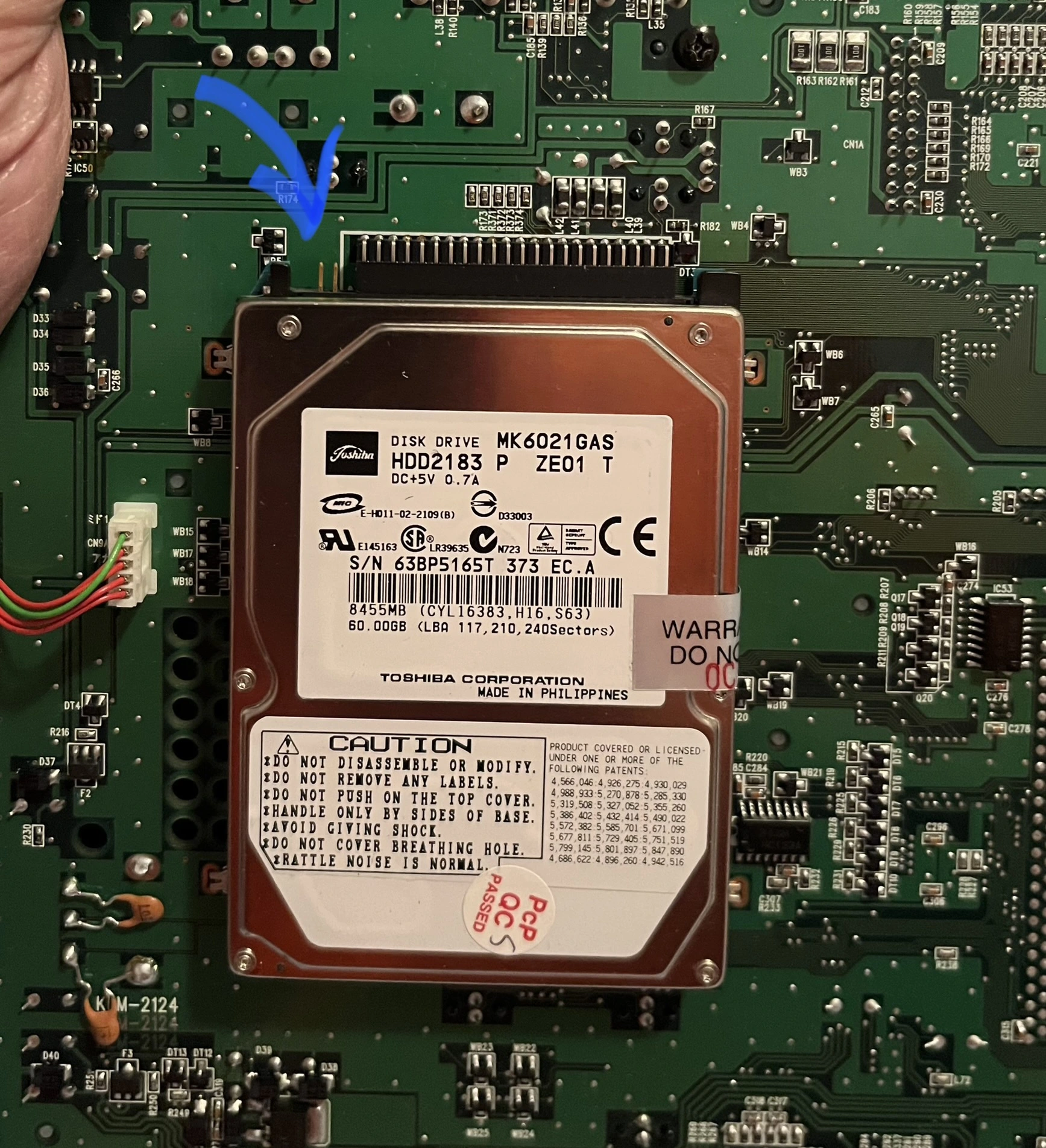

If I'm understanding you, if this D16 requires an IDE plugin, there would be a connector for such, and I don't see one, so that's a non-issue.
The attached pic you'll see the Toshiba 60G I installed earlier today. The blue arrow points to the 4 pins in question. The bottom 2, that your diagram shows to be B & D, are the two pins I must jump, correct? That will make the drive as Cable Select, yes?
So as I have it installed now, no jumper, it's set as Master, and it doesn't appear to want to initialize, Cable seems like the logical choice here, right?
I don't have any kind of device to act as "jumper", so could I simply (carefully!) solder a bit of wire or solder to jump those 2 pins?

I've done some more research and found this:
If you look at the hard drive, it doesn't look like there are any jumpers set, which probably means it needs to be left empty (master).
I found a Service Manual, but it doesn't mention any settings. It might be helpful for putting it together properly,
You might have to find someone with a PC that can test that drive to see if it is working properly.
Do you have the latest OS? The D16's latest OS is 3.12. Unfortunately, it requires a CD with a SCSI D connector, which is pretty rare to find these days. This is 20 year old tech, after all.
Beyond that, I don't have any other suggestions. I saw the threads about people upgrading to bigger hard drives. I don't know the limit that the OS can see, but the 40GB drive SHOULD work from all indications if it's good.
