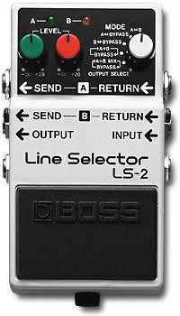

I've ordered two Boss switching boxes instead - but have realised that I won't be able to use them in the wau I wanted to. I've got two seperate guitars going to different channel of my amp and I want to switch between guitar1 going to input one and guitar2 going to input2, but all going through the same effects.
What I in-fact needed was one Boss switcher and one of those Morley switchers.
But it looks as though your handy box would be better at the start of the chain...
How much would you ship one to the UK for?
Hi Coldmate,
This Boss one would let you do what you want, you seem them regularly on Ebay, sure not as cool as one of OUtlaws boxes.................
here is the link to the use of the boss pedal www.bossarea.com
Good luck
Codmate said:
Damn - I wish I had seen that earlier - I need something exactly like that!
RE: $
You can email me but I'd rather not discuss that stuff here. I showed the inside picture though so if you can solder or know how it works, you can make one yourself though.
If you mean guitar 1 going to the amps hi input and guitar 2 going two the amps low input, that cannot be done. 99.9% of all amps only let you plug in one spot (the hi input for example would disconnect the low). Though once upon a time I had a Crate that let me and my friend both play out of it.
That boss pedal linked to looks very cool.

Cool - I may drop you a line sometime, or maybe get a freind to show me how to solder ;)
I realise that you can't have the high and low gain inputs of a channel plugged in at once, luckily I have a true 2 channel amp (Fender Vibrolux). I run my American Deluxe Strat into the normal and my LP Studio into the bright.
I want to be able to just pick up the correct guitar for the song and have all the same pedals (when I say *all* - I actually mean just a tuner and a TS-9 - lol) hooked in :)
It looks like the line selector will do it - I'll have a closer look at one in a local music store to make sure.

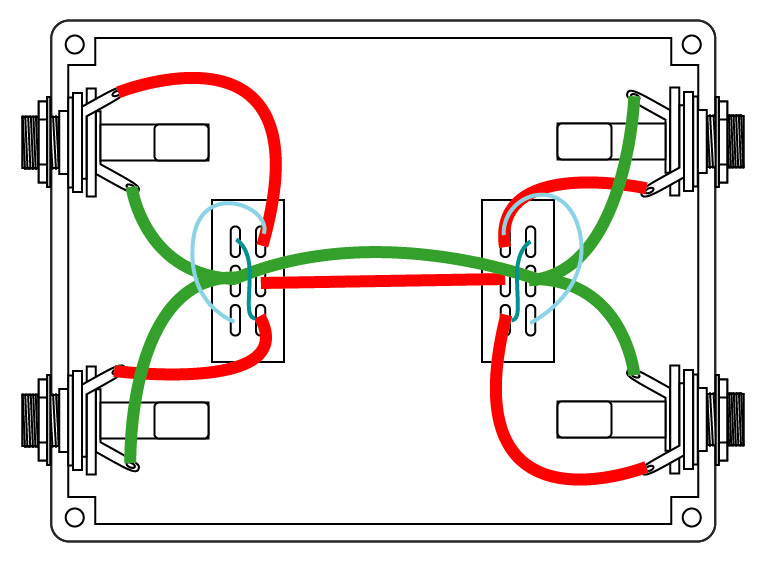

How to:
Here is a somewhat proper wiring diagram for anyone interested in making one. ;)
Does it allow you to send one guitar to two different amps at the same time?
Or better yet does it allow two guitars to go to two amps?
Anyway you have a cool idea and design.
No, a simlpe Y adaptor would do that for you. If you need on amp on all the time, and the second to turn on/off, then you could connect an input to another input so the signl is always on for one output.
Tat doesn't normally sound good anyways, but no.
But thanks for the comments.
