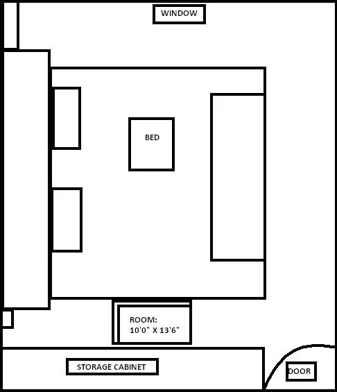

Now, as to the room. Clarify your dimensions. Is this a 10x10 room with a 14' ceiling, or a 10x14 space with 10' ceiling?
That is one HUGE window. Can you give a quick diagram of the floor plan including doors and window placement?

The Layout is: layout.webp
