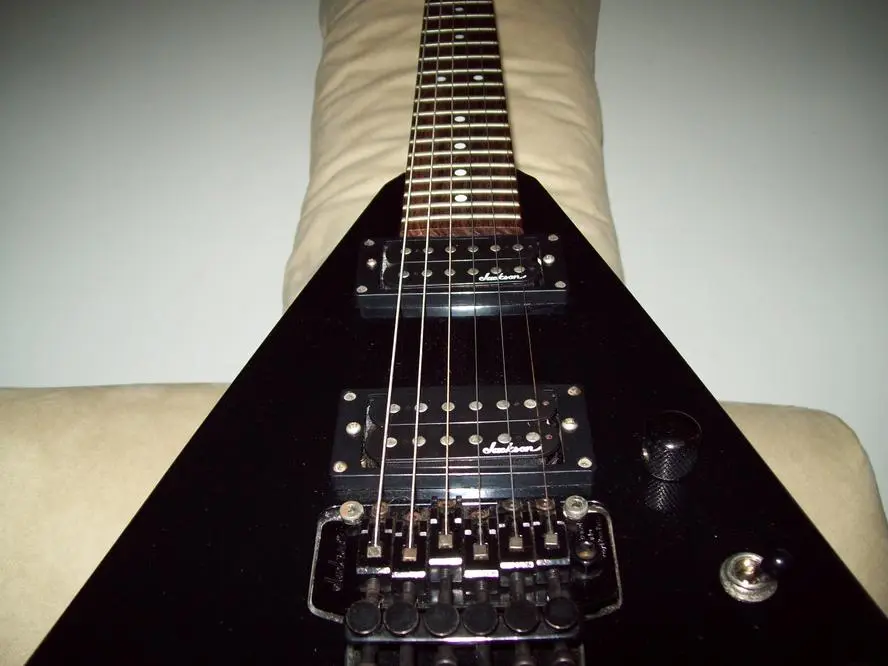

Here it is....

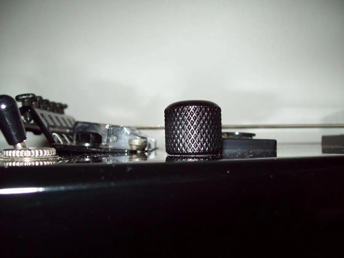

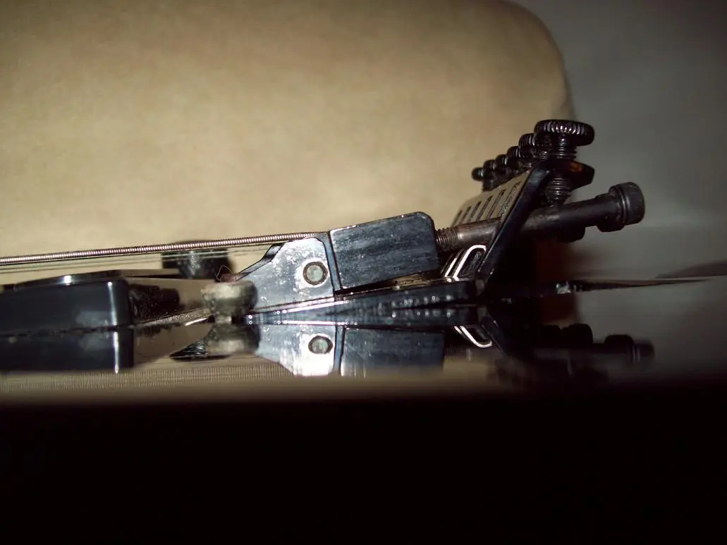

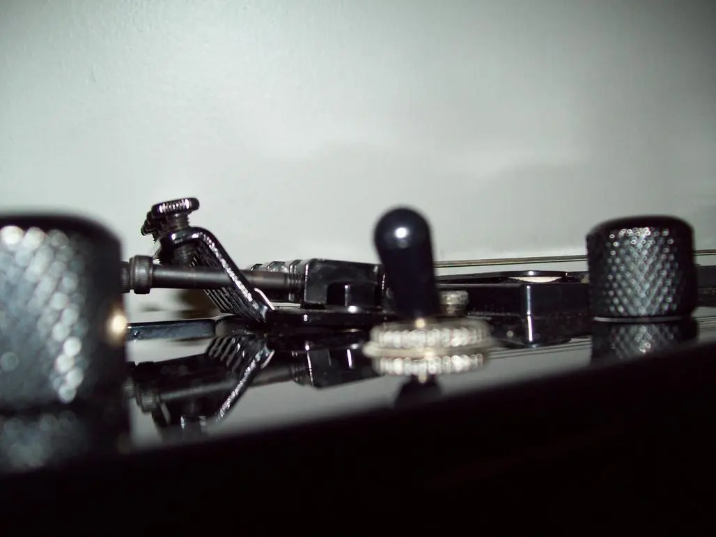

Here's a couple more showing the tremolo system lifted...
Wow that floyd really is out of whack. That happens when you take off more than one string at a time when installing new ones.
Yeah, That's how it looked before I put the new strings on.
I tightened (not too much) the screws in the back a little where the springs are...and now it is pretty much flush with the body.
Those are the "before" pics,...I'll post the "after", when I get some more batteries for my camera, as they just died after I took the pics of the logo on the case.
