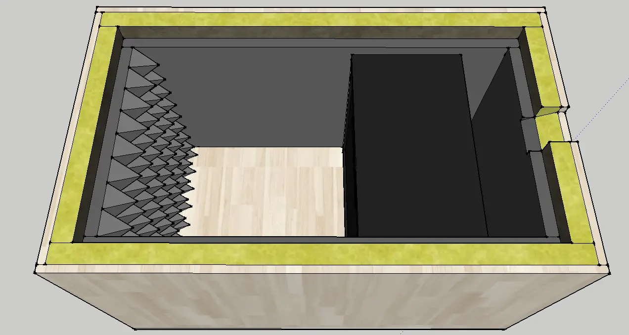

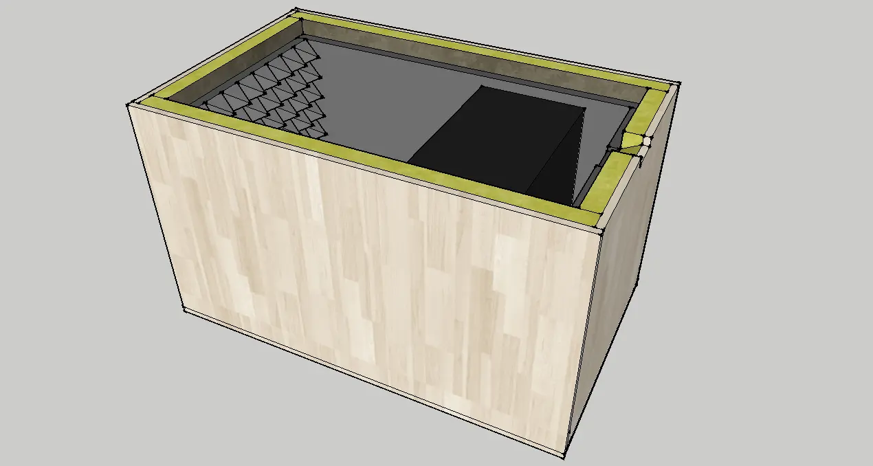

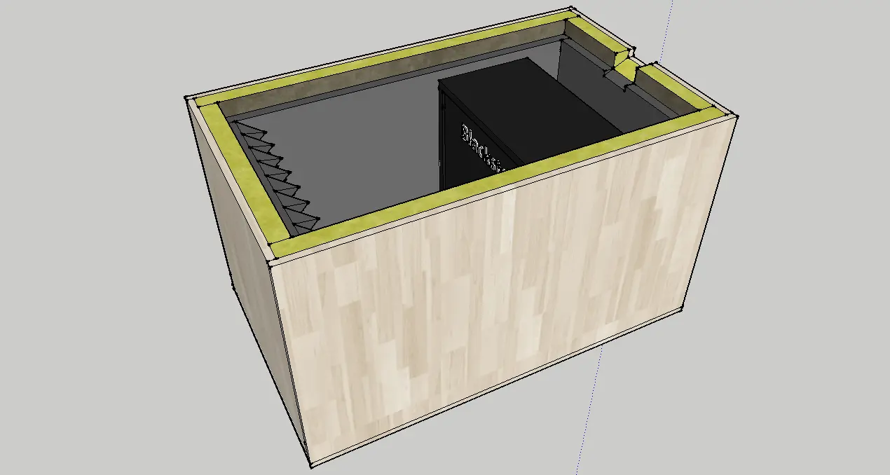

I thought I’d share my drawings of an isolation cabinet designed specifically for the Blackstar HT-112 speaker cab. I won’t be building it until Jan/Feb next year so i can’t test and post results until then. However, I made a very similar iso cab (just a bit bigger) about 5 years ago from similar materials which worked well, so hopefully this will too.
Some small details are missing from the drawings. For example, four steel corner braces on the base corners, latches for the lid to stop any chance of it vibrating or rattling and screw-in rubber feet. I did’t have the patience to draw the surface of the 25mm acoustic foam either. The surface of the 80mm foam took me long enough.

As i mentioned, I’ve made one of these before. I think the ply could actually go as thin as 10mm. My last Iso box was 12mm. I’ll make that decision when I come to it. PVA glue and flat-head wood screws actually provide a pretty solid construction but I use four metal corner braces for extra stability. Some sound will escape through the gap cut for the speaker cable and mic cable but this is minimal. The Blackstar doesn’t have to be played that loud to sound great anyway. The inner plywood base merely functions as a flat surface to keep the mic stand and speaker cab level. It also helps keep the box solid as the edges are glued/screwed into all four sides of the box. I’m sure some sound reflects off the floor, but from memory, it didn’t effect the sound negatively. I might experiment with laying a square of 25mm foam in front of the speaker cab with a hole cut for the mic stand.
Notes on the speaker cab
The Blackstar HT-112 is an open back cabinet. The dimensions are: W443mm x D249mm x H444mm. It should fit pretty snug into the iso cab… if I’ve measured correctly.
Comments/suggestions/criticisms are more than welcome. If for some crazy reason you'd like to try and build this yourself, just remember to double check measurements as I haven’t built this myself yet.
