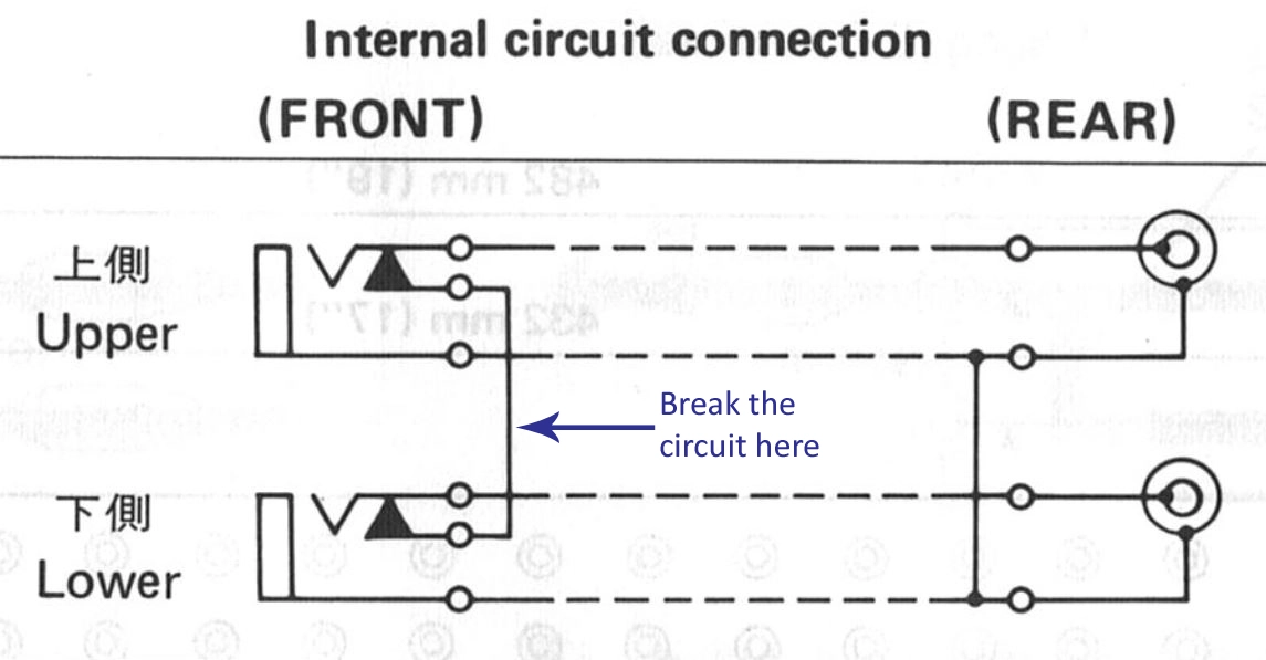

Id like to have the top row isolated from the bottom row. (non normaled, not half normaled).
Basically I want to use the device to connect my mixer group outputs(rca) and direct outputs (rca) so I can easily patch things out from there. I need them to be isolated so I can use the top row for direct outs and bottom row for group outs.
Internally the PB-32H consists of eight two channel modules.
To isolate the connections you need to cut the copper track on each of the module PCB's that link the two ¼" jack sockets, (see circuit diagram pic below).
