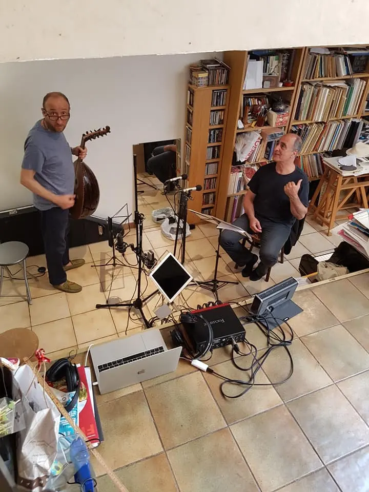

I recorded two instruments (arabic qanoun and a viola da gamba!) plus a narrator.
I opted to record as it was in the concerts that were done of this program.
So two AKG 414S stereo pair on the instruments
and two Neumann KM 184 stereo pair for the narrator.
The set up was like this 36563784_10155874688274436_9047943032497766400_n.webp

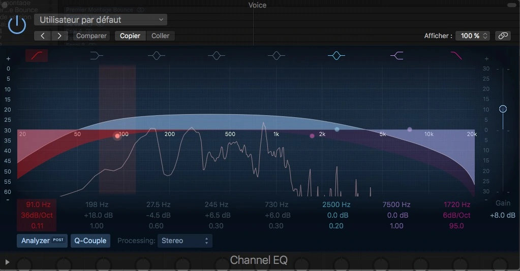

Here is what I did =

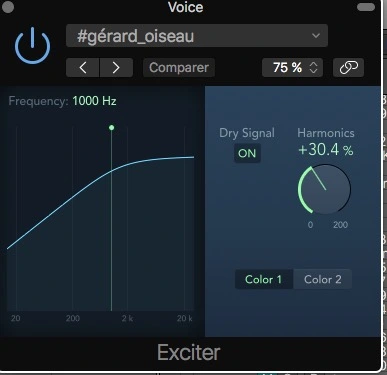

and this =

I think you're largely stuck with it because if you recorded as shown in the pic, anything you do with "tricks" to affect the instruments in the vocal track is almost surely going to introduce phase issues when mixed together. So, don't listen to the narrator in the future, or at least close mic him with a single mic!
Now, if he just wants his voice to be heard more over the instruments, and assuming that's how it is in his two tracks (which I'd just mix to mono and work with that), consider automating levels very slightly and ducking the instrumental tracks against the narrator track, and use more compression on his track, but I'd avoid editing it heavily unless it can be done without making the non-narrated parts sound different from narrated ones, i.e., in the final mix.
