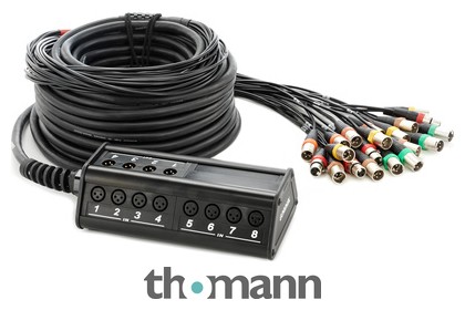

I ordered two multi cores from Thomann:
And
And the hum has sofar only happened with the Cordial brand.... ? No hum with the sssnake mc164.
When I connect the mics directly to the interface with simple 5m long XLR cables, also no hum.
Also the XLR connections on the cordial seem fiddly, they don’t have the ability to ‘lock’ as like in the sssnake model. And the cordial is the more expensive one with less inputs and rean connectors!! Very interesting...
i don’t rule out the possibility however that I may be going crazy tho and it’s just the tinnitus acting up ?
It's a fault - send it back. Brand does not make things hum, faults do. Disconnected grounds, and with long cables that are essentially floating, they're a great way for noise to get in. That is, however a lot of noise suggesting the system has troubles.
