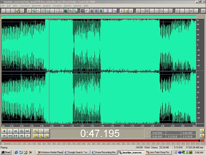

The following is a CE screen shot. Is that compression?
and one other question: Whats so bad about compression. Every article I read on the internet about it condems it as though its the worst thing on earth, yet apparently lots of cds are compressed.
whats the big deal? I mean, if it sounds better why not use it?

There's no way to tell from simply a waveform -- that could be a clipped waveform, a limited waveform, compressed....
Without seeing the original, it's impossible to know....
Compression, properly used, is very effective... it can be used to shape the timbre and tone of a track, or it can be used for dynamic control.
Since the effect can be subtle, it is very easy for the novice to overuse/abuse it and suck the life out of the track... you obviously have not been reading pro-oriented articles, because it wouldn't be dismissed out of hand. It is used often in studios, but of course, it is used properly.

I use being able to see the wavform on the computer screen and seeing the effects of compression more than actually hearing the effects..
Its not as mad as the compression used on Santana's "Smooth". The waveform is litterally one big thick green bar. :)
