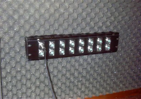

I built a bay that sits in the wall between the live room and controll room with 16 XLRs and a 2U blank rack spacer. Each one goes to a specific preamp and the then its line output goes to a 1/4" balanced patchbay.
a patch bay can be an extension of a mic cable, if done properly. I've seen it done in many pro setups, and do it myself. That way, you have the most flexibilty. Any "wall input" can be routed to any outboard pre, or the pres on the mixer, whatever...and then onwards. Sometimes connections will be normalized, within the patchbay, saving cabling, but not always in smaller setups.
