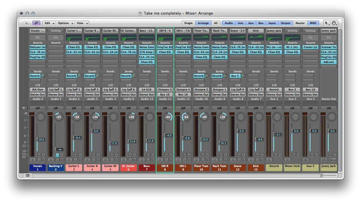

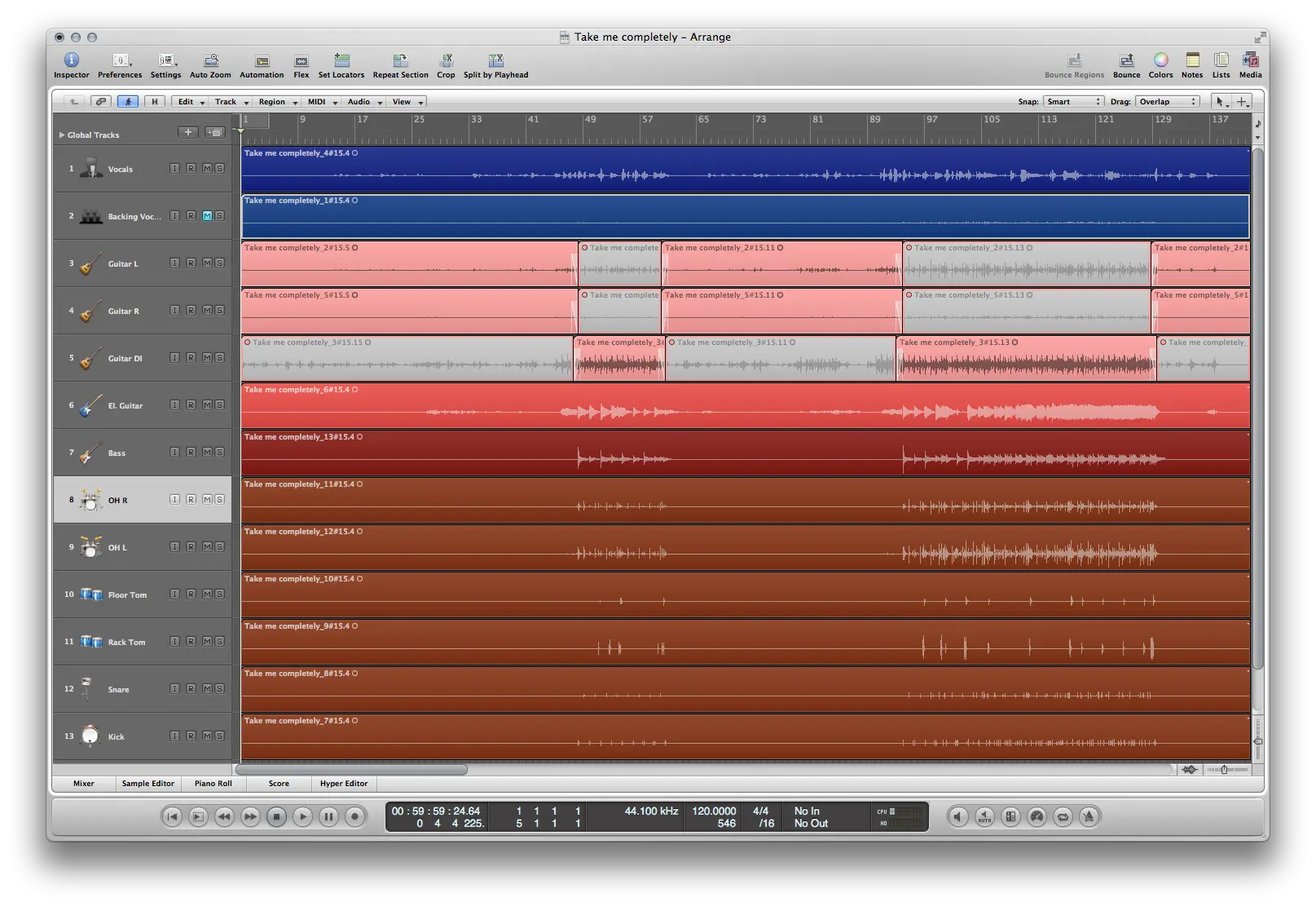

Other than that my toms are panned as if you're facing the drummer and the OH's as if you are.
And the bass squeal at the 2nd chorus.
Is there anything else you can hear that maybe I'm not picking up on that you would change?
Recording chain
Vocals - Neumann KMS 105 --> Focusrite ISA One
Ac. GuitarL - Shure SM27 --> Liquid Saffire 56 Input 2 (set to emulate great river pre)
Ac. GuitarR - Shure SM28 --> Liquid Saffire 56
Ac. Guitar DI --> Focusrite ISA One
El. Guitar - Shure SM58 on Vox amplifier --> Liquid Saffire 56
Bass Guitar - DI --> Universal Audio LA610 (Compressor enabled)
Kick Drum - sE Electronics X1R --> Liquid Saffire 56
Snare Drum - Shure SM57 --> Liquid Saffire 56
Rack Tom - sE Electronics X1R --> OctoPre Dynamic MkII
Floor Tom - sE Electronics X1R --> OctoPre Dynamic MkII
OH L - Neumann TLM102 --> OctoPre Dynamic MkII
OH R - Lewitt LCT140 --> OctoPre Dynamic MkII
All recorded using Logic.
