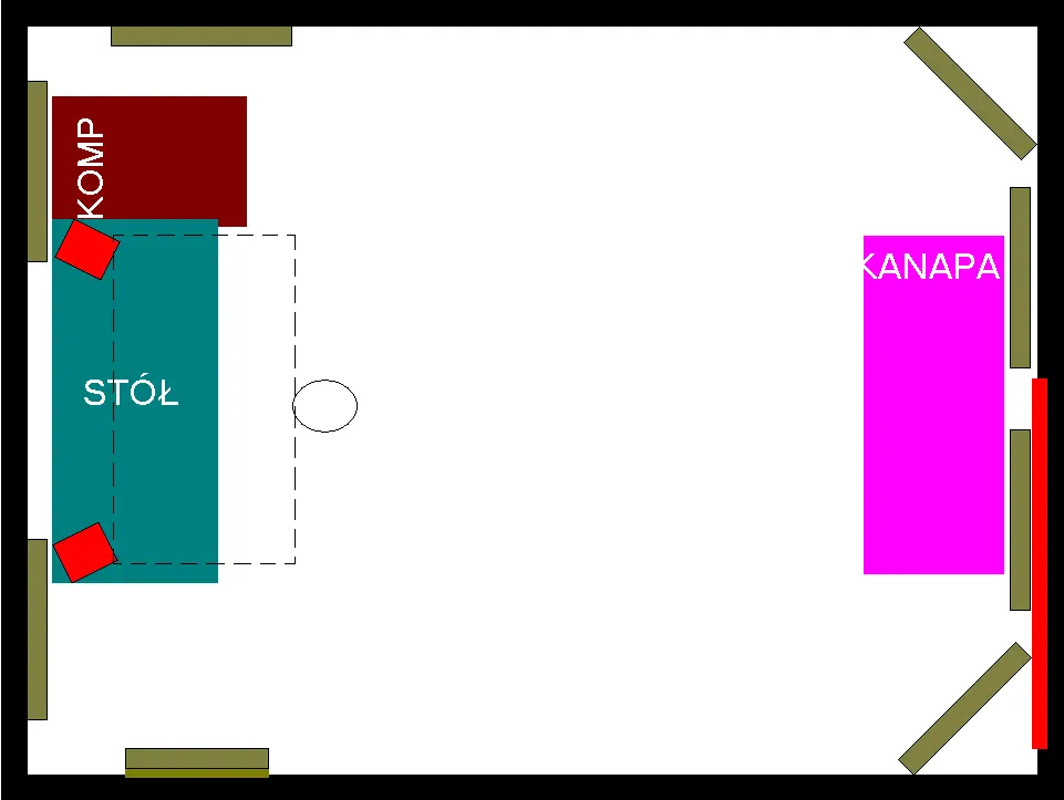

Ohh and buying a new guitar amp aint gonna help whatsoever in the mixing stage. Could you draw a picture of your room and I'll edit in where i think the room treatment should go?
'szafa' - it`s a segment
'kanapa' - couch
'stół' - table
'komp' - computer
The red line is window, and green - door. Horizontal lines ~3.5m, vertical ~3m. Carpet is between couch and table. Now computer is moved a little piece to left side (near the window i`ve got the radiator)
That`s all.
A segment? is the table a computer desk? Anyway, i would treat this room as shown below, with the 4" rigid fiberglass absorbtion panels in green/brown.
hm... segment ^^. It`s a wardrobe ;P.
On the table i do my homeworks. Comp has got the other desk.

Ahh, ok. Well you can see the basic setup anyway, so just follow that really.
