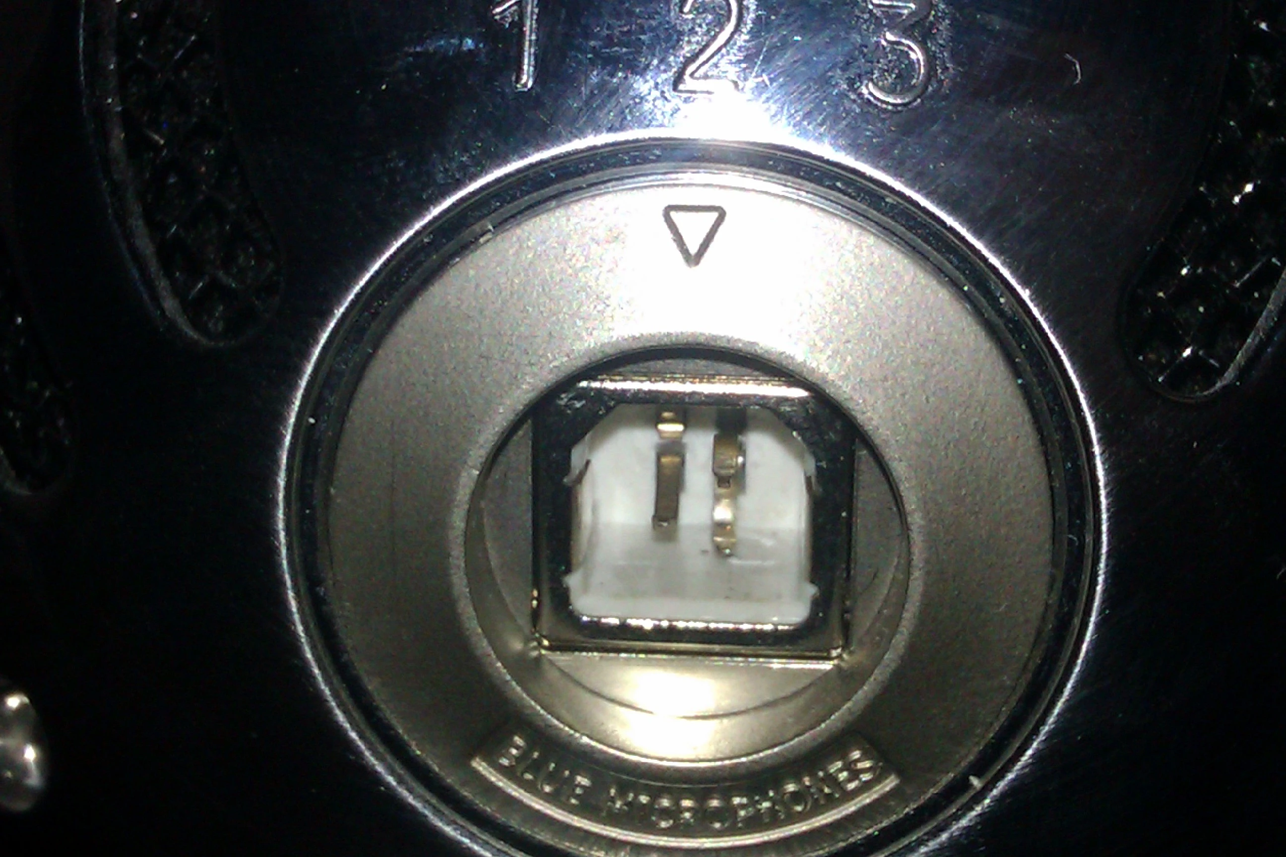

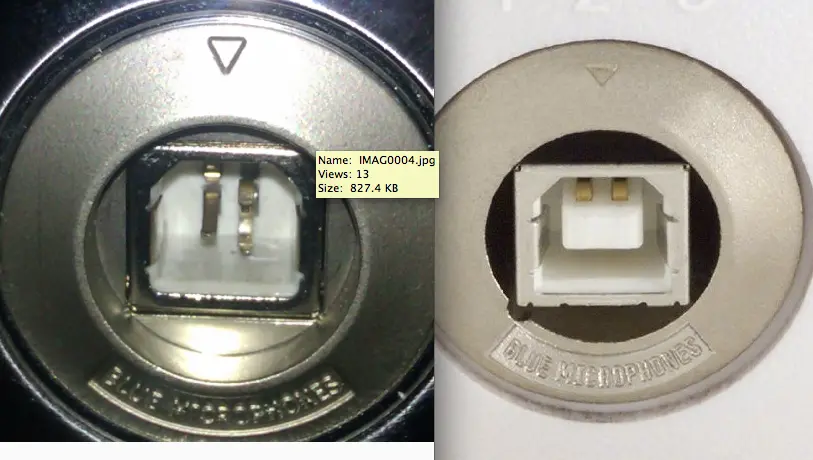

i have the blue snowball and it cant connect to windows anymore, i dont know if its the cable or the port its self, i looked at some images and mine looks totally different. do i need to buy a new one?

Actually, what it looks like is the piece from your computer or interface (wherever you plug it in) as broken off INSIDE the mic's plug. Try plugging something else into the computer's jack.
Yep, and his picture does not look like that. But it also looks likes that white plastic is flush with the outside of the jack. Either there is somtehing jammed in there, or the 'tongue' is broken off and the whole assembly has got pulled out towards the edge.
I don't see it.
That white outer is crimped in place my the metal faceplate.
The white inner is missing.

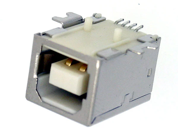

Op, I'm just thinking should you find the missing plastic block, you could actually put it back in yourself.
You'd have to glue the back of the block before you slot it in, and you'd also have to make sure you poke the tips of all four pins into the white block before you push it home.
That gives them a little bit of spring for good contact with the conductors in the cable.
