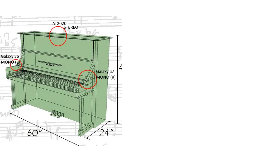

Thanks for all the replies.
So, this was my inital idea:
But the best might be the easiest; as mentioned above: keep experimenting.
Probably the hole lining up thing using a daw should be the trackiest part in my conception.
As soon as i do it, i'll post the results here in the thread.
