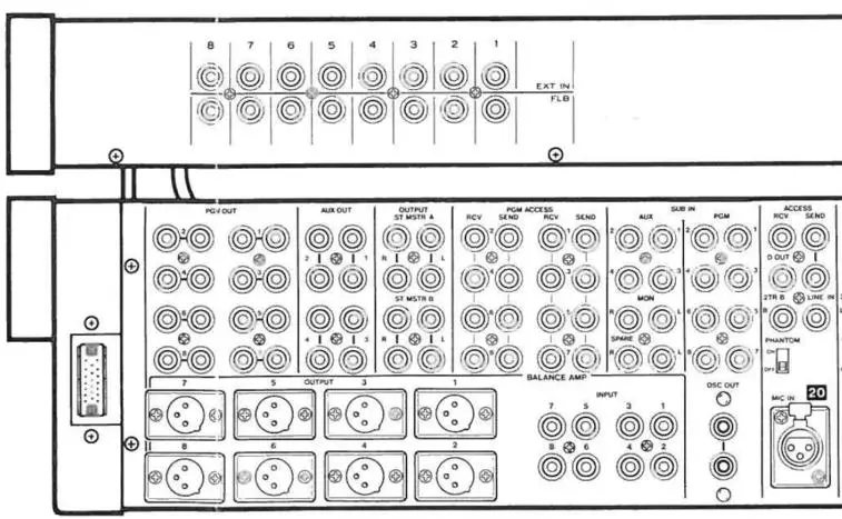

M-520:
  • The whole thing is unbalanced RCA ins and outs at -10dBV, BUT...
  • There is a sweet "Balance Amp" section. It is basically an 8-channel independent unbalanced to balanced converter...8 RCA's in at -10dBV, 8 balanced XLR's out at +4 or +8dBu. You can patch ANY combination of RCA outs to the Balance Amp and convert 'em to balanced +4. Maybe you want to run your Group outs balanced...bam. You can do that. Maybe you are running the board in more of a live setting and you want your 4 Auxes and a stereo main balanced plus a couple other long balanced runs using two of the groups or something...bam. You can do that too.

From the specs that Sweetbeats posted Im thinking that maybe even the M-520 wont do. I dont have to have a super complicated mixer but (correct me if Im wrong) I will need a +4 mixer with at least 16 ins/outs.
Since I know next to nothing about what is out there for mixers I have to rely on you guys throwing me ideas...Honestly the M-520 looks great. Its even a large format mixer that looks professional. Thing is that Ill probably never use the mixer in any other setup besides with the MCI or other large Reel to reel. Its too bad that its not a +4...
...and here I thought, from the M-520 documentation, that the board could be switched to +4.:o Thanks for clarifying Cory and sorry poop.:(
