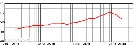

I have been using a MXL 2010 for recording vocals and I was looking into it and found this response graph on MXL 2010 | RecordingHacks.com
Anyway... I think the mic usually sounds pretty good - but I am wondering - for a vocal mic should I try to get something with a flat response graph? I have only recorded with this mic and some AKG's - the MXL seems to give a better bass response and a fuller sound all around.
I just wonder if a better mic would give me an obvious improvement in my vocal tone... :confused::confused:

Not necessarily.....certain responses work better on different sources, making them sound more pleasant. You don't always want flat (in fact, I wouldn't ever want flat).
I hate to take graphs as always being real' or what ever, but that is some serious tilt!
Type in at4047' a nice plenty bright (generally) for vocals and a known ref point.
That MXL looked like 'md421 teritory but I guess not. :D

It's pretty close on a large portion of the graph - I can't hardly hear above 8 kHz anyway :eek:

Most of those response graphs are smoothed out approximations.
It is a creative tool, not a scientific measuring instrument. Use whatever sounds the best on a given source. Flat frequency response doesn't automatically sound better.
A flat response can be more transparent. What you hear is what you get. Which doesn't always work well for vocals. The spoken word generally requires a bit of high end boost for word clarity. And in that regard a flat response mic can come off sounding kind of dark or dull on vocals. But it depends on the vocals. Get the opinion of the vocalist IMO. I've heard of people using something like a QTC50 on a vocalist, but the vocalists hated it, as it sounded too real. She wanted something more flattering, less her. You also want a bit of the brightness / high end bump to help bring out the vocal in a mix. Since it's probably the main melody, not some backing track.
Not that frequency response graphs are accurate. Depending on the mic. Some are drawn. Some are just print outs from the first mic in a batch of a thousand. So use your own judgement. In the end it's whatever sounds good to you. And hopefully the person / thing that you are recording agrees.

Flat microphones aren't always the best. Audition some microphones, or if you can't like me, post some clips of yourself up. It's very helpful. For me, I cannot deal with spikes in sibilance frequencies (like most people, but it's worse for me), so it eliminates a lot of options. Some microphones accentuate frequencies that are flattering to some voices. That's it. If flat were the best, everyone would record with reference mics.

to see some intense graphs, check blue microphone's website in the section for interchangeable capsules.
look at the responses of the b0 through b8 or whatever they're up to now.
the b6 is considered one of the greatest vocal microphone capsules of all time. the b0 is similar to an akg c12. the b7 (I think I'm remembering right) is similar to another famous mic. something liek that
but anyway, you'll see radically different frequency response charts there.
the one of your mxl 2010 is what I consider to be about the worst for vocals because it peaks at one point and that point isn't the best place imho. however on men it might sound ok... on women it would be bad I think.
vocal sibilance is often in the 8k area so it's cool to have a dip there, not a peak. air is 10k or higher so a peak up there is nice. presence is in the 4k to 6k area so a peak there is nice.
those are total generalities but they're starting spots for what I look for in a vocal mic.
