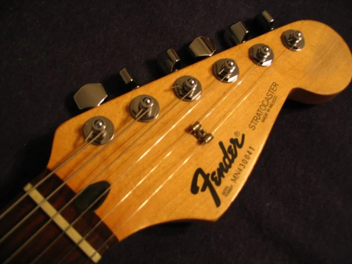

You can keep the string tree with staggered tuners, I did on my Strat. I used Sperzels. They worked great and I like them lots. I couldn't find the Gotohs for a decent price.
H2H
