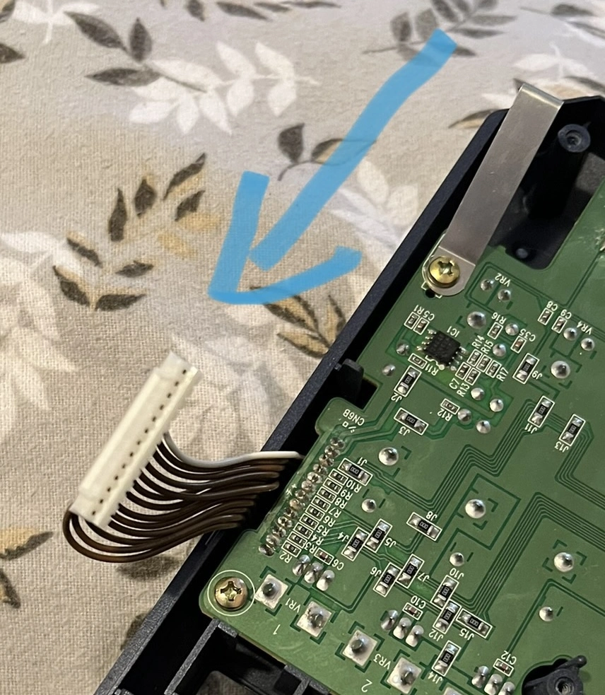

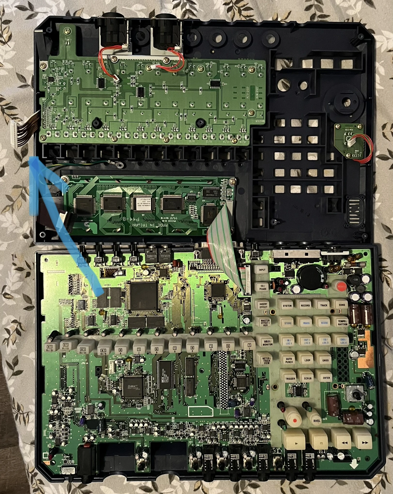

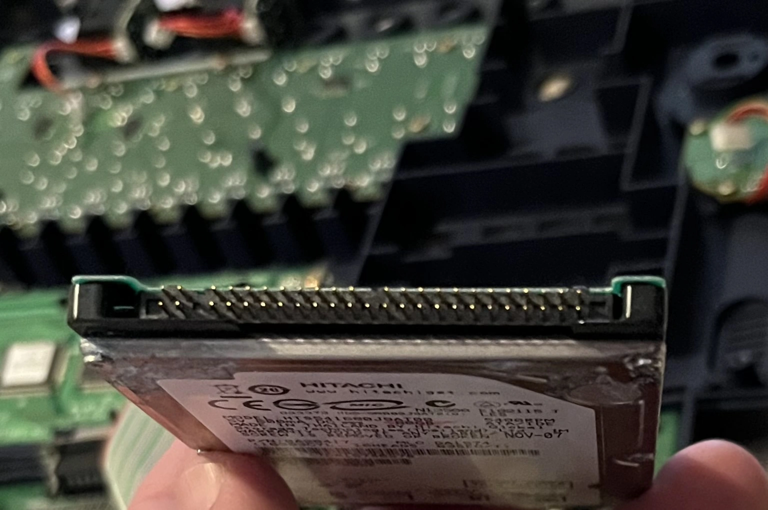

New to this site, but really need someone's help. I have a Korg D16 that's disassembled, hard drive out. Years ago, on an identical D16, I replaced its factory 2.1G drive with a Toshiba 60G drive. Initialized, worked fine, for years, not a single problem. I think I had upgraded to their 3.1 OS. On my second D16 I started disassembly and removed that factory 2.1 drive... and stopped there (long story!). Someone was holding both D16s, but unfortunately the working, fully reassembled D16, with the fully functioning 60G drive, went missing. So I'm left with the D16 who's drive is out. I have everything: power supply, all boards, knobs, screws, connectors, and the 60G upgrade drive, like new, sealed in original foil, no reason to suspect it won't work.
PROBLEM: I can't be sure where all the inside screws go, cuz I took it all apart years ago, and without the second, fully reassembled D16 in front of me (the one that went missing) as a visual guide, I can't possibly reassemble everything exactly as it's supposed to be. Any suggestions? But even more problematic for me is attaching the connector to the pins of the new drive (see 3 attached pics). You can see the connector is about half the length of the row of pins on the drive, and I remember having to plug in that connector to just the right spot, to just the right pins, for it to be installed correctly. I got that info online after a pretty long search (cuz Korg's tech people were telling me swapping out drives was not possible..."proprietary" hard drive, etc.), and when I installed it exactly as instructed everything worked great. But I can't remember where I got that info so many years ago, so, good people, any help with my issues here is GREATLY APPRECIATED. Thanks!
