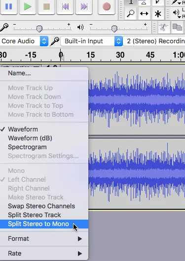

and I have no idea how, or how to fix it? If I can?
Basically, I dug up an old song that I had tracked, but never worked on. This was back in the day when I had no idea what I was doing...
Some of the tracks, You can't pan L/R. When I do, I loose the audio, gradually. At about 40 or 50 L or R, it disappears completely.
Im guessing I tracked in stereo instead of mono, but not totally sure. it was off an old mixing board a friend borrowed to me.
Re-tracking isn't an option, the musicians aren't around anymore. Are there any tricks out there that can fix this? Or am I screwed?
Appreciate any help from you guys, thanks.

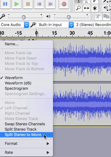

Not sure what you're mixing with, but I'd just drop your raw tracks into Audacity and they'll show up in stereo if that's what they are. Then "split to mono" and export the L or R track that has the content. Then, create a project with just mono tracks and you'll be able to pan all you want. aud1.webp
