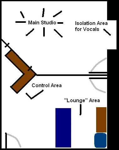

so after planning out different layouts with my friends who i am going into this endeavour with, we found one that is going to work. instead of seperating one room into two, i am incorporating the next room into the design. iam enclosign a very basic, not to scale drawing i did in paint real quick so you can see what i am doing. i wil update more as time progresses

I'm not quite sure I understand your layout for the control area. If you are planning on doing any mixing and hoping to get decent balance of what you hear on your monitors, you need your mixing position to be symmetrical within it's room space. As Michael Jones mentioned, check out the small studio samples at the SAE site.
