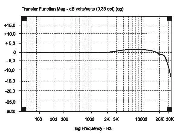

From a review of the NT1a at http://www.digitalplayroom.com/rode/reviews/nt1a/nt1review.htm:
http://www.digitalplayroom.com/rode/reviews/nt1a/nt1review.htm said:
However, one criticism I will make is that in the manual the frequency response graph has a vertical scale of ±40dB. This scale is so large that it makes the response curve appear deceptively flat, and makes the graphic information less than useful – Rode certainly aren’t alone in this practice and other mic manufacturers should also take note.
The actual response curve is anything but flat:
http://www.compel.com.tr/rode/NT1A/NT1AFreqResponse.jpg

Thanks dgatwood...you can't argue with that digram, I will send it to him.
