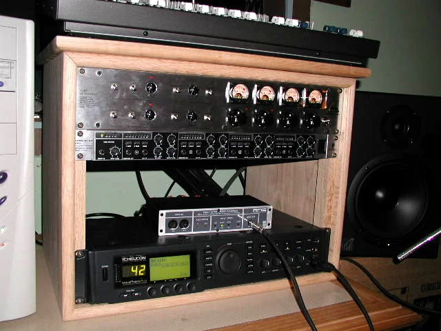

I thought i'd share a picture of a 8 space rack i built out of some scraps i had paying around in the shop. Most of its oak, one side is birch, the top is maple. I had all my stuff sitting on one of my monitors, and it was only a matter of time before it fell off. This is much better, wonder why i didn't make one sooner...

Nice job. They don't make too many racks with mitered corners.
ooooooooo pretty. nice rack, i love wood furniture and everything. looks so much nicer than plastic SKB cases and bland cold metal. it doesn't do anything for the sound, unless of course it is on your walls and floor hahaha. i like it.
Looks nice. I built all my racks. It's the only way to go.

hey guys,
I'm suprised at the response i've gotten ...my construction methods : the sides hare held together with four stretchers 19" wide with pocket holes made with a Kreg Jig. the Oak strips that the electronics attatch to are just glued onto the sides. In a face to face grain situation like that, and modern glues, it's way strong. The front trim is rounded over with a 3/8 roundover bit and then glued on as well. there are holes in the top stretchers that the top is screwed on to. that's it. Pretty simple. I have a small custom woodworking business at my home. I could make these for you guys and finish it light , medium, or dark. Different woods etc. I'd sell these for $35.00 for 8 space, and add $2.00 for each additional 2 spaces. 10 space = $37.00 for example. You pay the shipping. I do take Pay Pal. I think that's a pretty good deal. When finished, they would look great. I use a HVLP sprayer, and either laquer, or a waterbased polyeurothane....I'v been considering doing other custom stuff music related, guitar stands, music stands, etc. But not sure if the market is there. I'm in a small town in Idaho....Maybe you all can help me out and get some nice studio stuff in exchange!

Quick questions: Are you screwing the gear in the wood or are you using rails? How much is shipping? Thanx.

Digital Smith - The units are screwed into the wood. A 1.25 inch piece on solid oak. They won't come loose. I'm estimating the shipping around 20 dollars, i'd have to get one boxed up and weigh it to be sure.
