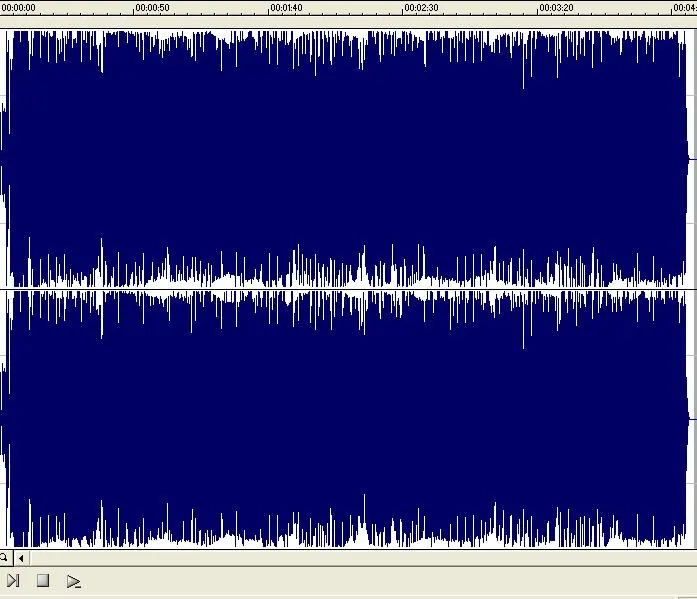

It starts to clip right after the intro and conyinues clipping throughout.
I think you need to remaster so it doesn't clip. I don't think you need another plugin I think you already have the tools.
BTW - good tune, kinda repetitve but okay. With a shot it could be hot....:cool:

Don't DECLIP go back to before the "mastering" & rest your levels etc so that it doesn't clip like Ido1957 recommended.
Drop a load - is that defecating ecstacy?
TOO LOUD TOO CLIPPED.

What Ray said. If the original tracks aren't clipping till you mix them, then just turn it the heck down at the track level. Do your mixing at a much lower level until you are at the final stereo mix. You can ALWAYS make up gain, you can't take away clipping, no matter how clever a plugin thinks it is...
