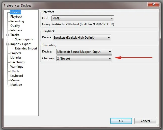

In Audacity stereo tracks can be set in preferences so when recording starts it'll be stereo. Perhaps Audition is similar. Not sure if this helps or not. Audacity can not use USB ASIO drivers and would use Windows audio stuff, which may have some setting buried in a Windows control panel.

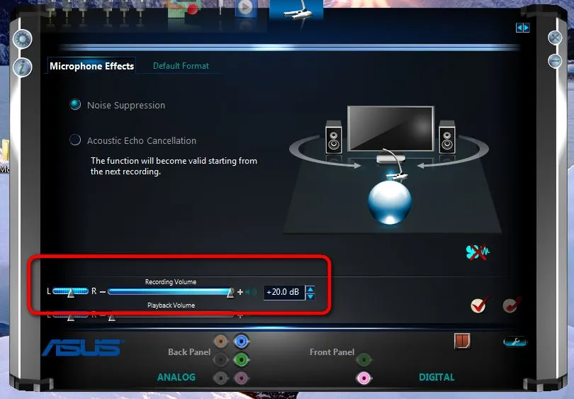

Realtek may have a control panel where recording gain can be increased for the Mic input (would not affect a USB mic or interface).
