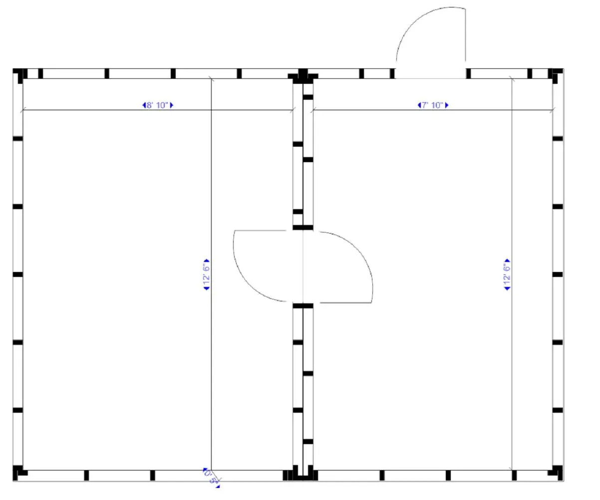

And I'd like some thoughts on the intended design.
I have included a jpg for reference.
First off, this will comprise about 1/4 the space in my basement.

I do realize that square/rectangular rooms are not the best, and I am open to ideas from any and everyone. I'd just like to hear/see them within the coming 2 weeks, before I get the ball rolling.
I mean, for what you're doing the proportions look fine. You can't really make either room smaller if you're going to stay with two rooms. I know you don't want to, but I'd strongly suggest going with a single room...8'x12' is really small for a drum room...tough to get anything but a very dry, close sound. The control room will have to be bass trapped from here to eternity.
I'm not saying it can't work, I'm just saying that you're building in some limitations by going with two rooms that you will not have otherwise. The trade off of course is that you have to track with headphones, which can be tough when it comes to judging phase relationships.

Yea, I realize it's a pretty small room, on both accounts. but, I feel it's pretty necessary to do so. I'd love to be able to expand into more space, but it just doesn't really exist.
And, I like hearing, so I don't really want to spend hours a week with earplugs in, trying to judge if I've got mic's placed right. So, I'll deal w/ a very small, dense room. I am fine w/ not having too much room sound. I typically do heavier music, so dry drums are what I like anyway.

Frank beat me to it. One room would be way better.
Edit: Oops. Posted at the same time as you did.
If you are dead set on doing two rooms I'm not sure how you could do much better than your plan there.
You are going to have some difficulty achieving isolation when you are in such close proximity and with such a small space. You may end up listening to drums and amps all day anyway.
I moved from a 1 room 13 x 9 studio to a one room 30 x 20 studio and the difference is night and day. I don't really get a ton of "room sound" but it doesn't sound like I'm recording in a cardboard box anymore either.
At least consider it. Lots of people do it with great results.
Use the basement if you have no alternatives. I did and had a series of nightmarish problems.

Just a thought, I know you didn't want to wear earplugs while getting your kits miced, but I think your space(s) will be very, very difficult to use.
I think the main problem will be physical access - if you have a monitoring/mixing desk set up at 38% of either space, you are in the way of the door path for getting in & out. I suppose it does not matter if you are never going to move any kit in or out, but it's going to be awfully tight!
It's also going to feel claustrophobic - and I don't know about you, but the vibe of the room matters, especially if you are trying to be creative.
I'm speaking from experience; I had an 11X11 room with a miced up kit, mixing desk etc, there was not really much room for anything else.
With the narrower spaces you have, once you have stools, and some guitar amps etc, it is going to be pretty awkward imho.
Another consideration is ventilation - you now need to provide HVAC for two spaces, that are acoustically separate from each other.
Also, acoustically isolating these two rooms from each other is going to eat up space you could use for bass traps (absolutely necessary, especially in small room). (I had 144 sq ft of 4" depth OC703 in my little space).
if the basement is cleared out at this point, maybe lay some tape out on the floor and put your kit in and see how the physical flow is, you may want to reconsider your two room plan.
my two cents, ymmv

I do long, grueling sessions of drums for metal bands. and then equally long sessions of guitar's. I just do not feel that one room will make for the best of my abilities.
Now, I do realize that 2 smaller rooms pose it's own list of issues, probably worse than my issue of sound levels in one big room.
I'm not 100% opposed to one big room, would a big room w/ a small booth for vocals, guitar cab mic'ing. I just need tips on what/were to build it.
I can always do drums in another open area in the basement, but that won't be nearly as isolated from potential outside noise.
A booth is a fine thing to have, especially if you need to do live group stuff and have an isolated vocal track. (soft vocals, classical guitar et)
For the space compromise in your situation (huge, 50%?), and the type of music (Metal), I can't see giving up the room for it.
Now, an isolation cabinet(s) for guitar and bass amp might be worth the trade off.

What about a smaller booth, like big enough for a human to stand in. Add space for some rigid fiberglass.. and a window. also, could fit a cab or 2.. I typically re-amp w/ multiple amps, cabs, all going in unison.

If you're dead set on chopping up your space, nothing anyone says here will make any difference.
You have to decide where to make the compromises; if you think you will be comfortable for the long term in some pretty small spaces, then go for it.
If you want to put a bunch of money and effort into figuring out how to HVAC two rooms and isolate them from each other then go nuts dude.
You want pay for a couple of sets of half decent sold core doors and the trouble of installing them, have a party.
I really wouldn't worry about sound isolation from the outside world, seriously.
I will sum this up, and wait to hear how it goes.
If you are not going to track anybody simultaneously, then you do not need a booth.
If you are going to re-amp you do not need a booth.
You need a decent sized room to work in, and some good acoustic control and bass traps. The smaller you make the room you are working in, the harder these acoustic concepts are to enforce.
I know the cool pro studios have booths, and iso cabinets and control rooms etc, but they also have more than couple hundred square feet to work in. How did you record your myspace tunes? I'm willing to bet you didn't have to duck/twist jam stuff into a tiny room where you had to squeeze in besides your drums and were worried about hitting the ceilings or sidewalls.
Just my two cents - your music sounds good for its genre, good luck with it!'

I used my old 8x8x8 square bedroom w/ blankets and some corner traps i built.
Yea, i know, tiny room.. barely fit the drums in.
I'm more concerned w/ the random cough or noise from upstairs creeping into my sessions, not really the cars or trucks outside. To be honest, I can't hear much from outside the house. And even at full volume inside, you can't hear a ton, outside...
The booth would mainly be for my own sanity, and the occasional need to re-take something due to an errant noise in the overheads. I do replace a number of instruments, and I have an Iso-Cab for bass and for guitar.. but nothing beats pounding 2 or 3 amps, and blending microphones.
Maybe i'll do a full size room.. gah.. so much to think about.
