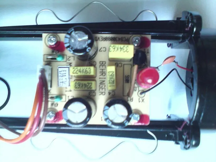

hey here is a pic of the inside of the C1.. Finally got it open! lol
I was thinking the little ceramic cap coming of the capsule could be swapped for a higher quality one? just as a little experiment.. You think this would make a difference?

Ditching a ceramic coupling cap (the one you're talking about) will almost certainly improve the sound noticeably. IIRC, the once most folks suggest are polypropylene film or polystyrene if you can find , but usually that means mail ordering. Mylar film is still a really big improvement and you can usually find those parts at the Rat Shack. Oh, wait, you're in England. No idea what stores there carry.
Any chance of posting pics of the capsule? Some electrets use stock inexpensive capsules that can sound pretty good. A circuit mod might make a useful mic.
