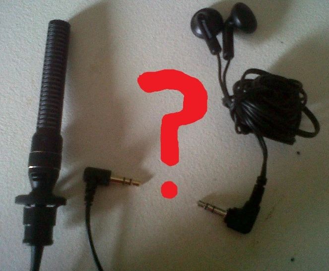

Hi,
My dilemma is very simple, I wish to listen to live sound from a basic 3.5mm output microphone using 3.5mm input headphones/speakers.
There obviously needs to be some kind of intermediary amplification - but what piece of kit would best do the job?
It needs to be battery operated, small, and cheap! :thumbs up:
Thanks! Clay

I didn't look at the photo initially. Based on that - particularly the TRS jack on the mic and the fact it's a shotgun design - I suspect that mic requires video-cam power. You can get that from (i) an appropriate camera, obviously, (ii) a preamp intended for videography, which may cost more than a cheaper camera or (iii) cleverly wiring up a batter-power supply yourself.

An additional issue is that I agree the mic you picture looks like an electret designed for use on a video camera. These often DO require a small amount of voltage (provided by the camera) to work. If you know for sure this one doesn't, great, but...
Now, my suggestion. You mention that you have a variety of other mics available to try, including XLR ones. If so, move to XLR since you'll have a lot more flexibility in terms of gear to hook them to. Then, for the XLR mic scour eBay for the cheapest, nastiest Behringer mini mixer you can find. The start around $60 new so I'd hope you can find a used one for well under $30. This'll give you something you can plug an XLR mic into, a mic pre amp and a headphone amp, then a socket for a headphone.
