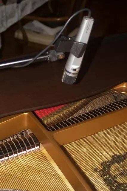

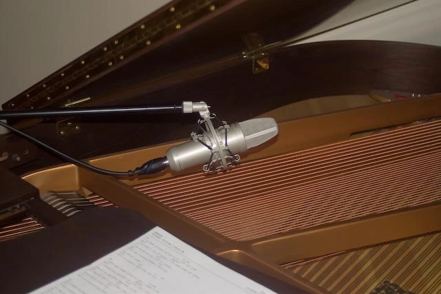

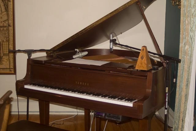

Hey all, i'm new to this forum and to home recording. I am currently faced with the dilemma of recording a Yamaha GH1 Grand Piano (5' 3") with the only two microphones I own: An MXL 909 Large-Diaphragm Condenser and a Shure PG81 Small-Diaphragm condenser. I would like to know what the best technique would be (placement, eq?, etc.) to get decent sound out of this configuration.

1. Player's perspective.
I'd probably put your MXL over the bass strings. Give it enough space as not to be touching the strings and not touching the lid. Put the Shure up towards the treble strings. I'd put the mics on a diagonal for a nice stereo image. Unfortunately I can't give you a clear picture of this. You'll need to trust your ears in the cans for placement--I hard pan this, and I generally get pleasant results.
2. Audience perspective. Open the lid to top stick. Set up some stands and throw the mics up... Up to you on how close they should be... but place them parallel on each end of the piano, facing the piano, as if it's on stage (which it could be for all I know.)
I'd probably have the Shure audience left.

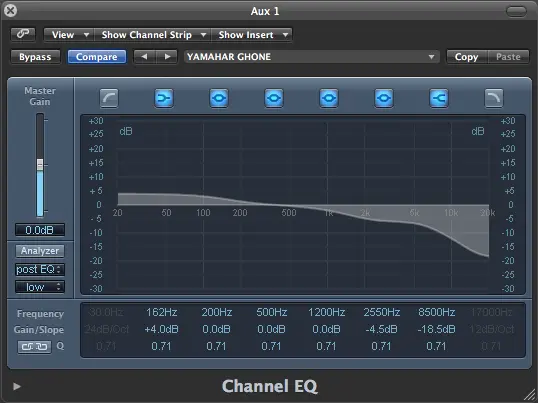

Once again, things like EQ are all going to depend on things like the room you use, what method of micing you choose... and the material being recorded.

Thanks guys! The recording came out great. I'll post a link to an mp3 sometime soon.
-Nick
