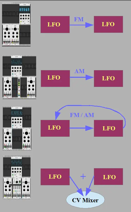

Inother words: let´s talk about frequency modulating LFOs, aboutmodulating the modulation strength (the “volume” of an LFO´soutput), about feedback loops consisting only of LFOs, and aboutadditive mixing of different LFO outputs.
Youcan imagine what complex networks we can build with these fourbuilding blocks.
Andif we use different LFOs of such a network to modulate or triggerdifferent sources of sound, we are able to construct a “super-cycle”(which consists of a set of “sub-cycles”) that lasts a very longtime until it returns to its beginning.
Andwhen we further take into account, that frequency is not the onlyparameter, which we can modulate, things get really exciting:modulating the LFO´s amplitude, the LFO´s phase and even the LFO´swave shape (if our LFO is equipped with a CV in jack allowing us tomodulate the shape).​

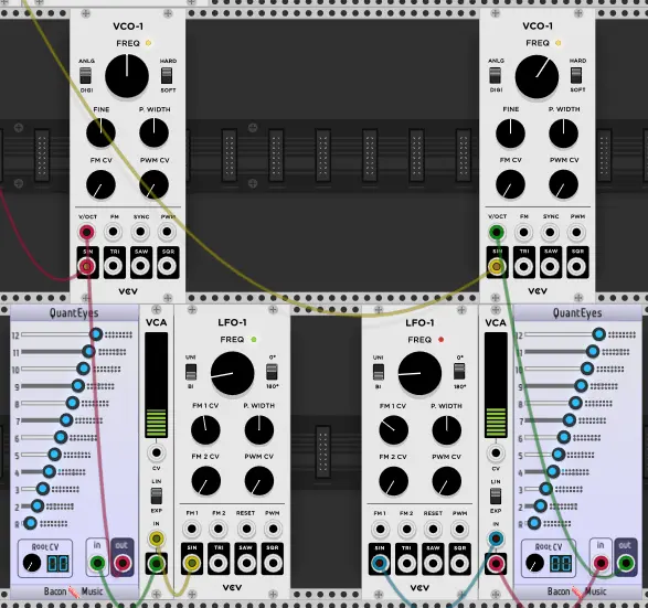

Asimple example shall explain what I mean:

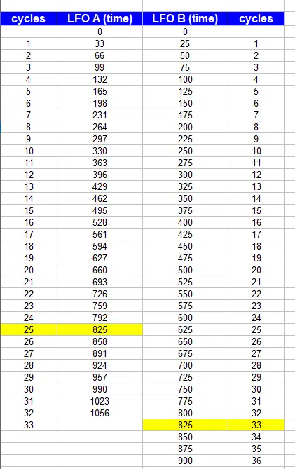

Let´stake two LFOs, LFO A and LFO B. LFO A runs at a frequency of 0.03 Hz,which is a cycle length of 33 seconds. LFO B runs at 0.04 Hz, whichleads to a cycle length of 25 seconds.
LFOA modulate the frequency of a VCO, let´s call it “VCO X”, andLFO B modulates the frequency of a VCO called “VCO Y”. We can usetwo quantisers and two VCAs to make things more comfortable to hearand to listen to.
Touse the aforementioned terms: we have one “super-cycle”consisting of two “sub-cycles”.
Pleaselook at the following table now: it lasts all in all 825 secondsuntil both LFOs begin their cycles at the same time again. LFO Aneeds 25 cycles to get there, and LFO B needs 33 cycles.
Thelength of our “super-cycle” is 825 seconds, even if the“sub-cycles” are only 25 seconds and 33 seconds long.
Thevideo “Video C1_1 SupercycleVideo” (just follow the link:) demonstrates the patch.

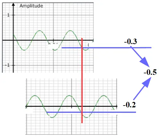

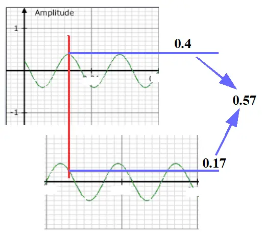

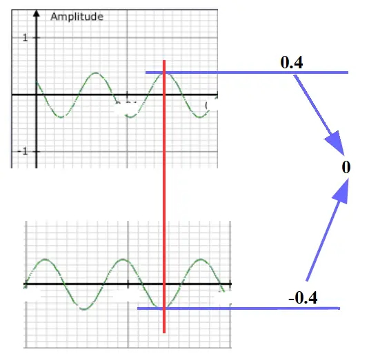

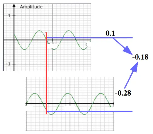

Theeasiest group of LFO networks – easy in terms of predictability –are additive ones, networks in which all LFOs work parallel on oneand the same (ore more than one) modulation target. Let me start with1 VCO as the target and 2 modulating LFOs. In those cases theabsolute values of the LFOs add to each other: when the phase of thewaves of both LFOs are positive the sum is a higher positive one, ifboth are negative the sum is a higher negative one, and if one waveis in its positive phase, the other in its negative phase, then weget a subtraction, and in case the waves differ by 180°we get a complete phase cancellation.

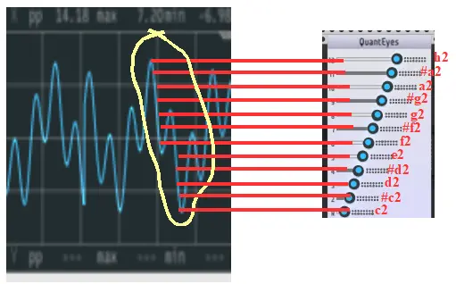

Theresulting summing wave may look like in the following picture (justan example). And patching a quantizer between the LFOs and the VCO weget the following melody (given that we have chosen the outputstrenght of the LFOs adequately (later more about adequate modulationstrengths).
Inthe region marked in yellow the patch will play
h2-#a2-a2-#g2-g-#f2-f2(will be held for a while given, that the local minimum is stillnearer to f2 than to e2) and then continue with#f2-g2-#f2-f2-e2-#d2-d2-#c2-c2#c2-d2-#d2-e2-f2 (will be held for awhile again) and then back to e2-#d2-d2-#d2-e2-f2
Withboth LFOs running at different frequencies we get random soundingmelodies with patches like that one.

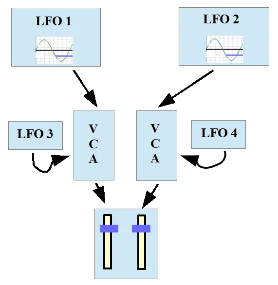

Ifthe channels of our mixer are equipped with CVins, we can modulatethe relative strength of each LFO by other modulation sources –e.g. using more LFOs. And if our mixer doesn´t have CV ins, we canpatch VCAs between each LFO and the mixer.​
ButI´m anticipating what will be talked about later.
