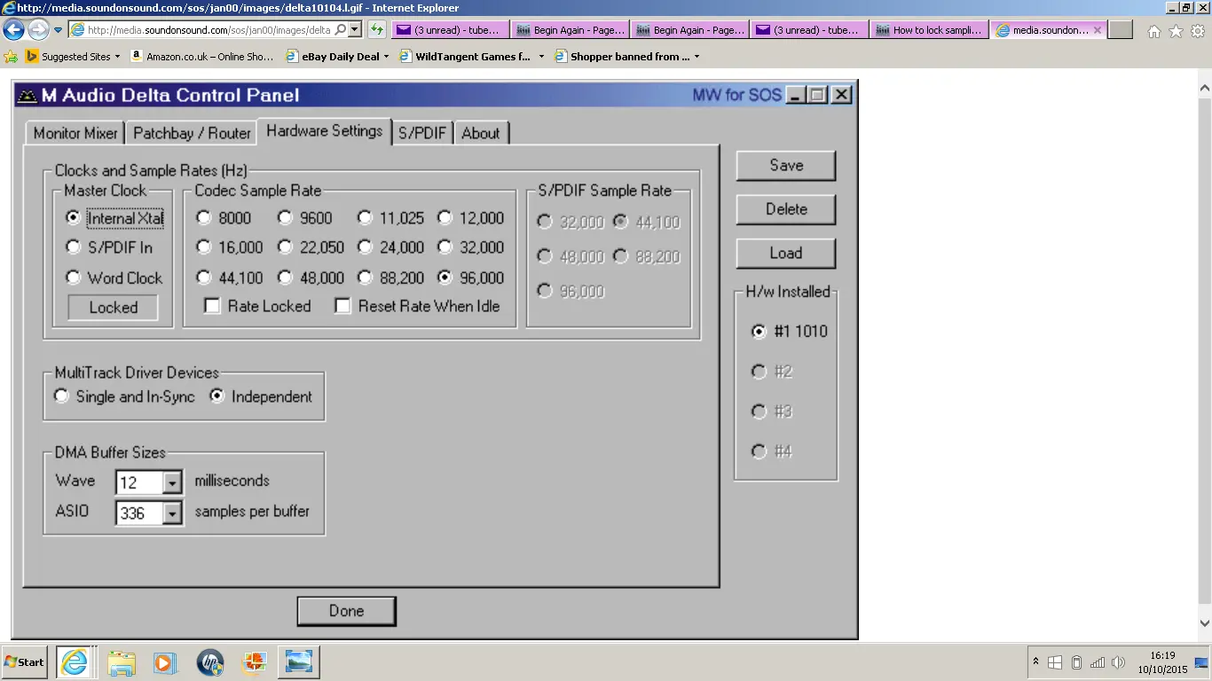

(B) Check to see if you're (the Delta) mapping through Windows -- Don't. Windows is probably trying to set the rate.
See attached.
Set rate, set to "locked"?

I would lock it.
But what I'm getting at is in (Device Manager...?). You don't want Windows mapping through the Delta. You certainly don't want it as the default sound device if you can help it.
