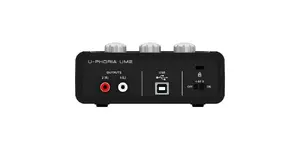

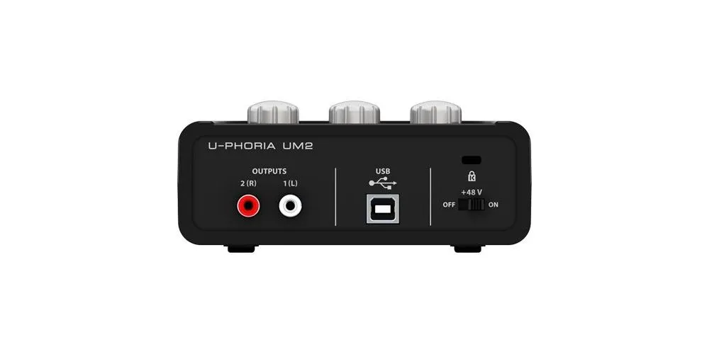

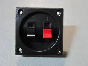

Hi, I owe a pair of very nice speakers that I want to set up with a Behringer U-Phoria UM-2, but I don't know how to connect these. The speakers come with a regular peaker wire input, and the audio interface comes with two RCA outputs (R/L). How could I set up this?
You're going to need an amplifier between the interface and the speakers. A decent home stereo receiver would probably be okay. Most studio monitors people here are using are active, with built in power amplifiers.
^^ What he said.
If you have a pair of very nice speakers with inputs like that, I'd expect you would have a stereo amplifier around the place to drive them. Get a set of RCA to RCA leads, plug one end into the interface, and the other into an aux input of some sort on the amp.
