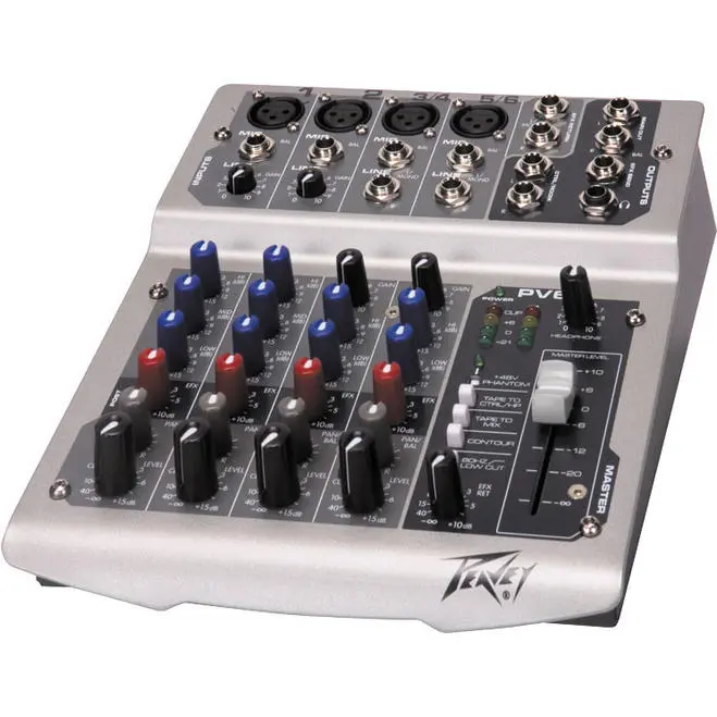

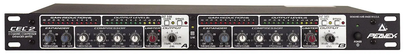

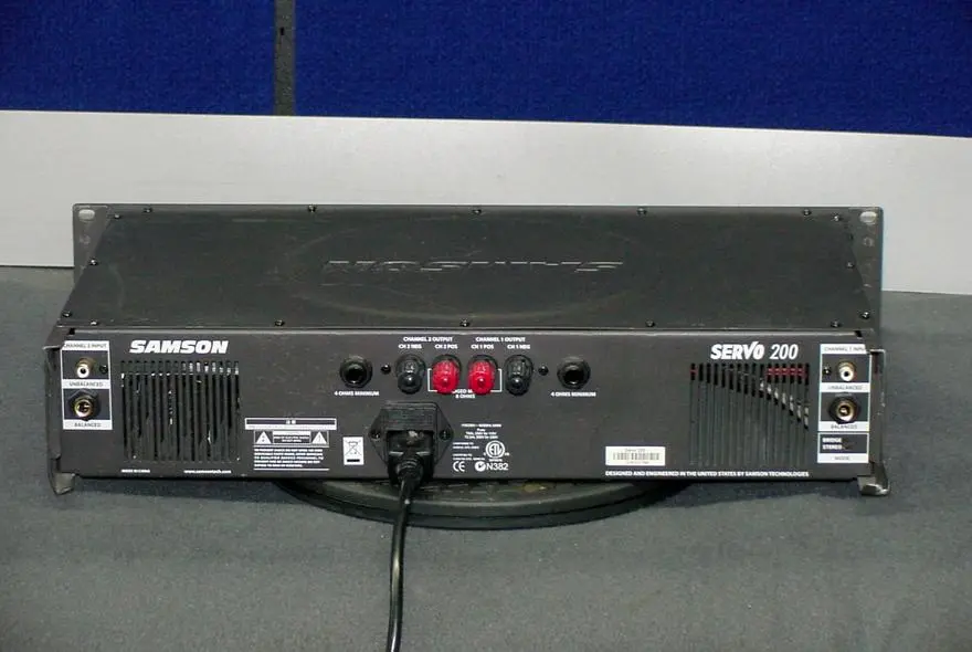

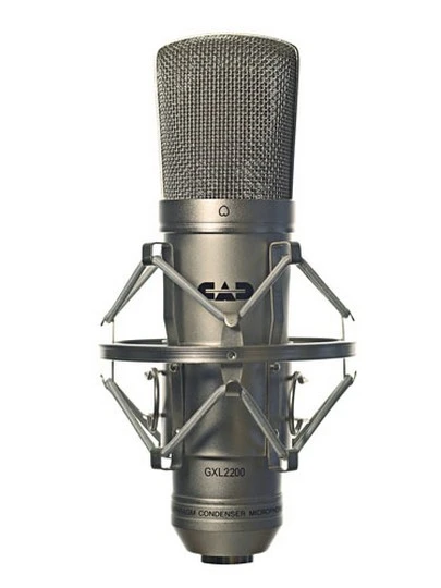

Okay, so recently i have learned the an essential part of equipment i was missing was a compressor. So after looking my setup I am getting pretty overwhelmed. This is what i am working with. All mixing is done through my computer using Sonar, I have a PV6 USB mixer, a CAD GXL2200, Peavey cel2 compressor, and an amp that drives my PA speakers. I have attached some pictures to help, what is the best way to hook all this together? Thanks for any help... Nickles

If so it would be Microphone ---> Mixer ---> Compressor ---> Amp ---> Speakers.
Not for live... speakers are just to listen after I am done, problem i am having is the compressor comes after the mixer, it seems as if i am going to have to go straight from the compressor to the computer to record? IDK, what do you think?
You shouldn't need the compressor till after you have your tracks recorded then you use the compressor.

For recording? It isn't essential at all. The plugs are as good perhaps better in some cases- and available in flavors and styles the would cost thousands to do in hardware.
Main reasons to comp in the the way in; If it can get your signal closer to it's 'finished target so there's less to do in the mix, or that particular hardware does something special. Since it can't be undone it also presumes useing actually hit that target needed in the mix (It's totally possible to get it wrong :D
If you're going into the computer USB that mixer doesn't have (that I can see) the normal patch point for it; either an 'insert for the channels or the main fader, or after the mixer's output > comp in > comp out to a converter> to the cpmputer.
I hooked it up last night how you finished that post. whole path was... USB audio out from the computer (right channel) Microphone in to mixer (left channel), from the mixer the MAIN OUT is going to the amp, then the CTRL OUT is going to the compressor. Then from the compressor I went from 1/4 to RCA(left and right chanels), which turned into 1/8 into my Line in. I tend to get loud on the mic sometimes. LOL

Well yeah. Wasn't that the whole point about the compressor. That would be your compressor plugs, or/and automation ('Track Fader or 'Clip Envelopes in 'cake speak
It was a quick partial listen but really it's setting ing there pretty well already. I didn't hear any big (as in time length) -phrases or words that dropped out. Off the top I'd say comp. Try a bit of 2:1 moderately fast attack and release, a few db to start.
